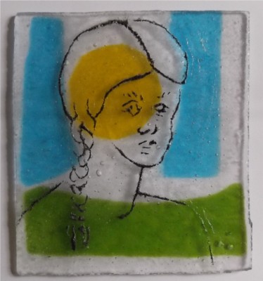

I like drawing. It is not simple when fusing.
I have made few tests with a graphic method.
The image is carved on a plaster plate.
The grooves are filled with glass powder.

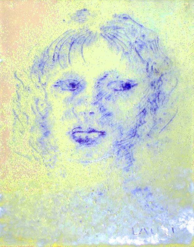

Susan was the first one, It was frit casted. Very good resolution, not enpugh saturation.
In the self portrait "Dirty Old Man" I used black liquid stringer.

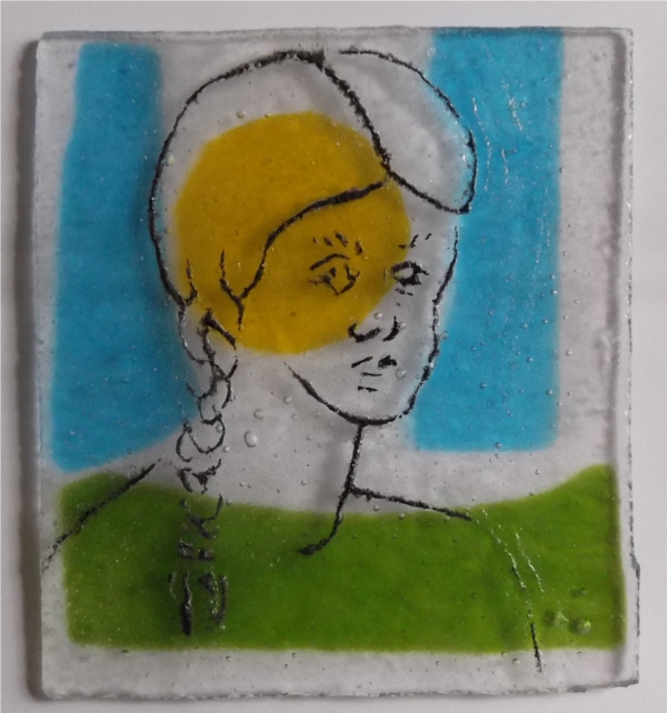

Nerd Girl was a combination. Fine powder and tekta.
In the last two pieces I have approached Ferdinannd Leger's way to separate line and color.
I hope these can give inspiration to some artist like Raphael or Carol Carson.
-lauri
P.s. sorry the pictures are not in the order of the text
Nerd Girl
Nerd Girl
Susan, first attempt

The Susan ihas only blue. The background colors are atifacts I could not photoshop away.

That was my point Carol,
to share the technique with someone who can do art with it.
What is gGassline? Is it some kind of liquid stringer?
The plaster plate I cast against an waxed window glass to get a good surface.
Carving is with any sharp object. Dental picks are excellent.
The groove is best filled with powder.Some medium is necessary to pack the powder dense enough.
A sheet glass does not pick the color well. I sprinkle a thin layer of clear
fine frit in between. When it beads up before fusing to the plate, it picks the darker powder well.
The prints are one of a kind. It is very difficult to keep the fired plate intact.
-lauri

Susan and Dirty Old Man (self portrait) were essentially frit casting. So one firing.
Nerd Girl was also fired only once.. The color fields are on the opposite side of the sheet.
To Morganica's question. To soften a sheet so much that it pics the color from grooves takes time and temperature. It is much more reliable to use a layer of fine frit or powder under the sheet.
I tried one piece with dry powder without the intermediate frit. The result was very much like a charcoal drawing. That is a variation that needs further study.
Also the possibility to lay a color powder (with binder) on an uncarved sheet and the by carving get white lines on a colored background.
