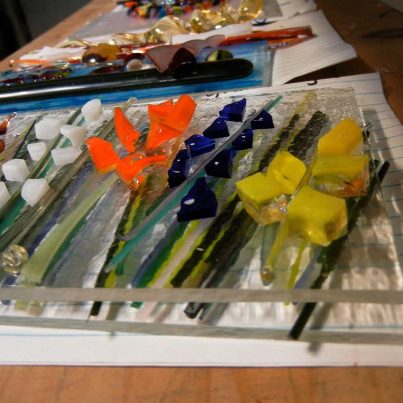

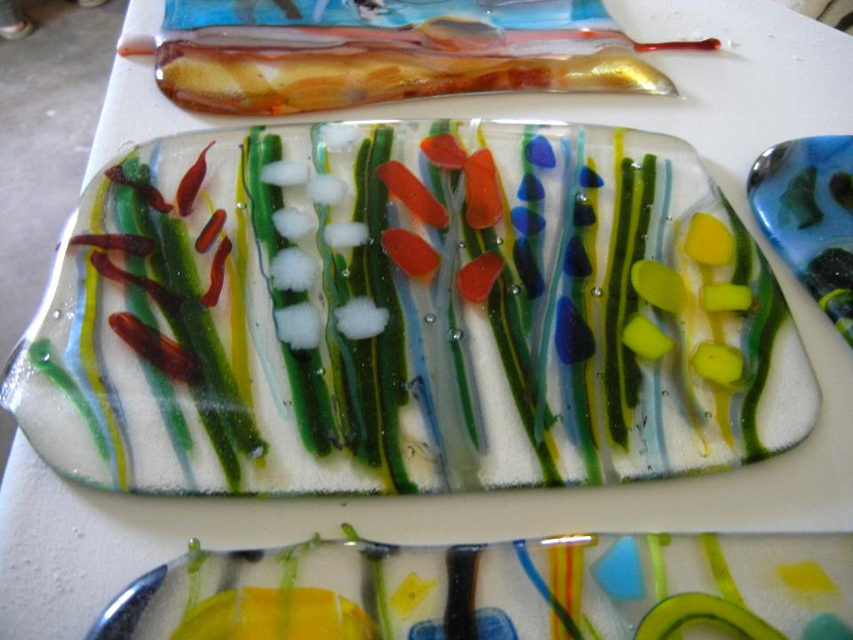

This TECHNIQUE gives lots of DEPTH
(and it should be left in TECHNIQUES and not moved to photos)
There are a few tiny bubbles in the piece after the first firing. To eliminate bubbles entirely, use a chad.

Possibly because it's photos of a fairly typical layered fusing layup with little or no explanation? And no, using a chad is not likely to eliminate bubbles "entirely" in a layup like this.
You would get more control over the final outcome (and the bubbles) if you fused the layers separately, then stacked and fused again.

It's the "new folks" I'm concerned about. What you're showing in these photos is what every new glass enthusiast, including me, does in the first few times they flat-fuse something in the kiln, i.e., they stack a bunch of glass and chunks in the kiln then nuke the heck out of it to see what happens. What they pretty quickly learn is that it's a great way to make bubbles, the chunks spread a lot more than they'd imagine and the different colors start moving up and down in the glass. Nothing wrong with that...but you're presenting it as a valuable technique they should learn, with absolutely no additional information about what's going on or why, or the fact that there are better ways to do the same thing.Dairy Queen wrote:Marty,
