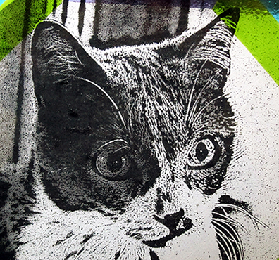

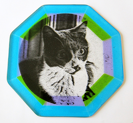

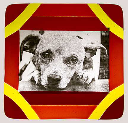

This is my first picture post so I hope I get it right. These are screen printed images from photographs both are 12in x12in.
Any comments or helpful suggestions with technique would be grateful.

A lot of getting a good image on the screen is tuning your exposure time. If your image detail is washing away you're probably not exposing long enough or have a bad printer giving you light transparencies. I'm also using Reusche high temp. black (3000) but am switching over to the lead free Raven black I can't really see any difference in the color density.

William, yes, I agree on the exposure and that is what has been giving me problems. I'm using two UV lights in a light table, but it's not enough, even at about 25 minutes exposure time. My next idea is to skip the exposure problem and just send a graphic image in to one of the screen printing supply places that sell exposed screens and at least have a proper exposed screen to work with. I just need to come up with an image that is worth spending the money on to have them burn for me. :D

Mike, getting your screens exposed for you might be a good idea, having the right equipment makes a big difference in getting good detail. You might want to also check out your local community college. I've been taking night classes to get access to equipment that I could not afford or have room for. The techniques for printing a shirt or poster are the same as printing on glass it's just your dry time is a bit longer and oh ya hotter.
I haven't used the fusing paints, Sunshine worked well but would only screen through a 150 mesh, Reusche will screen through 200 mesh.
One more tip I got from wgbb that I will pass on is that to control bubbles that lift and pull your image, dust crystal clear powder over the enamels before your fusing it's like night and day difference.
