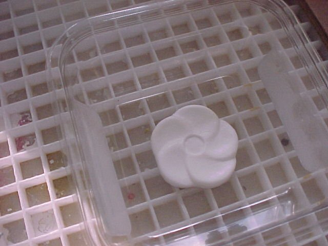

For the 2005 Magless Exchange I cast a hundred or so litlle 1.5" flowers as part of the design. I encountered a problem with the small open face mold not filling the edges because of surface tension.
Here's a picture of the flower. I won't post them here but I have a nine pic series showing how I made it work. Essentially it was the pressed casting process that you are interested in. Send me your email and I'll send the pictures.

Tod, I tried sending the pics and process info but the email gets bounced back. I need a workable address. I sent you a PM but I can't attach pics to it.
Jim "The Hobbyist"
