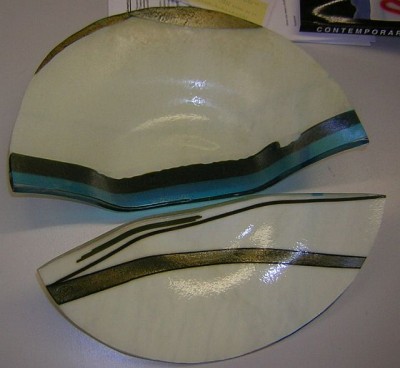

Just took a 14" diameter, 2.5" deep, 7-8 mm thick bowl (BE glass, first time with irid) out of completely cooled slumping mold and it broke in half where piece of transparent irid over tekta butted up against piece of french vanilla. Looking at the split, there is some tekta that slid down between the irid and french vanilla pieces....so there must have been some separation in the initial fusing, which probably caused some stress and the crack. The edge is sharp so I suspect it broke during cooling. I would like to try to save the glass by flattening them and cutting up for parts. Original schedules, which have been successful in my kiln before was

I'd use a standard full fuse schedule, but go fairly slowly on the upramp, probably 200dph up to the full-flat fuse, and hold for 15-20 minutes, then take it down. That'll flatten it pretty well.
I'm a little concerned, though, that the crack is so absolutely perfect along that color line. Do you have an irid to irid join, or is there a possibility of some incompatibility along that line?

The crack is from the speed of firing owing to the differential of rapid heat absorption between the clear and opaque glass.

The bottom layer was half french vanilla and the other half was pieced tekta. Top layer was pieces of turquoise irid and french vanilla.
I expected the center strip of irid to react and fully fuse over the gap. I now think I should have held it at mas temp longer to more thoroughly fuse. That joint had enough stress so when slumped it ended up breaking. I still have a lot to learn.....but if I don't have some failures along the way, I won't feel like I am trying to broaden my understanding.
I'll heat the pieces slowly and anneal longer and slower and hopefully be able to cut it up and use it in something else. And maybe try a similar design with only the bottom irid layer pieced.

I reheated them on a kiln washed shelf . I don't my exact schedule now...will post it when I get back to my studio. I remember it was something like 200F/hour to 1450F then used standard BE anneal schedule. Said the standard prayers to the kiln goddess and now I have 2 flat ovoid pieces, slightly larger than the original diameter due to stretching during the first slump. Now I'm waiting for inspiration to use them in something else....
