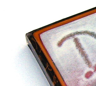

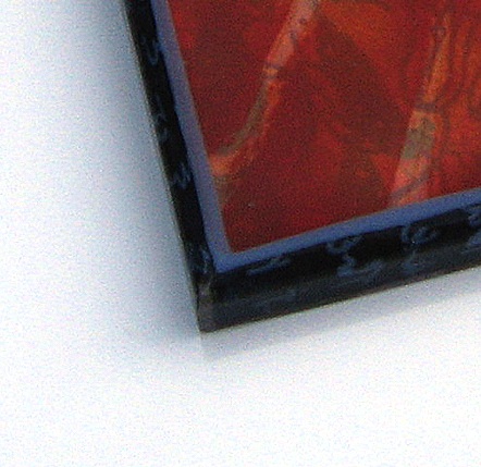

Re: Do touching pieces fuse together or might there be a gap
I beveled the corners on some thicker pieces I made last year because my design elements needed to be seamless:

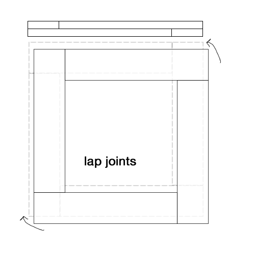

I think Brock's right. Long time ago (maybe 8,9 years) I tried it, with uneven results. I was just grinding the edges to a fairly acute angle, and joining them. It worked but I'd frequently get gaps in some part of the line and assumed it was because my angle was off and/or I'd removed too much glass there, or possibly the hand-rolled glass was a bit thinner in those spots. I decided that the extra effort wasn't worth it--if you could absolutely control the angle and thickness of the glass (i.e., if you were cutting at an angle with a good saw on machine-rolled glass) it'd probably work well. For me, it's faster and easier to do straight cuts, then either overlap the pieces slightly, or simply flip-n-fire.
Flip-n-fire's pretty foolproof if you've got a good, flat kilnshelf without dings, enough glass and you can clean off the bottom surface before the next firing.
I do this with picture frames and such--I use thin glass (mostly because I'm mixing colors) and lap the joints at the corners, like this:
It's similar to what Dana's talking about. As long as you're using the same colors any pullback will blend into the layer below. I've had it show a bit in pale, transparent colors (I think because of tiny bubbles veiling at the edge), but otherwise it's pretty seamless.

Morganica wrote: It's similar to what Dana's talking about. As long as you're using the same colors any pullback will blend into the layer below. I've had it show a bit in pale, transparent colors (I think because of tiny bubbles veiling at the edge), but otherwise it's pretty seamless.
It is what I'm talking about, but you have nice drawings :)
