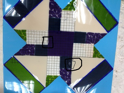

Hello evry one,
I gave glass good conditions, so why do I got 2 pop bubbles.
55 150 15
140 570 10
90 780 15
af 510 120
55 287 10
off room tep.
Thank
Osnat

Re: Schedule advice
If you are capping with clear, the design of the piece is prone to bubbles -- anywhere two pieces come together, gaps between the two pieces will cause air pockets, which result in bubbles when fired.
There are many schedules here on the board and on the Internet for a "bubble squeeze" which will help to alleviate this problem.

Re: Schedule advice
On a busy design like that I would not cap it with clear. Even with a good bubble squeeze program it will be prone to problems. Your schedule is very odd all around.
I would fire it
250 / 1100 hold 30 min
50 / 1250 hold 60 min. (bubble squeeze)
350 to finish temp (depending on the look you want)
9999 to anneal hold 60 min
100 to 750 hold 30 and off
If you really want that clear on top fire it face down for the first firing the flip and fire.
You can try 100 to 1250 for you bubble squeeze .....all I can tell you is that I do not have bubble problems with this above schedule.
