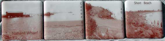

I Fuse the glass first and fire to 1380 and hold 15. This has always worked for me.

They're lovely Bob!

Jane Moore wrote:They're lovely Bob!
Thanks Jane, those are coasters with pictures of our little town. I sell them in sets of four and they sell very well.

Just a quick question Bob, how do you manage to get the images to go right to the edge like that ... all the instructions I've come across say you need to leave a gap ...

Jane Moore wrote:Just a quick question Bob, how do you manage to get the images to go right to the edge like that ... all the instructions I've come across say you need to leave a gap ...
Jane :D
Jane, I sent you a pm.

Great pieces Bob,
Your detail and especially the saturation are great.
