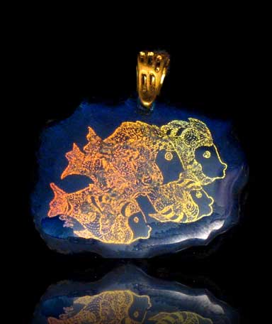

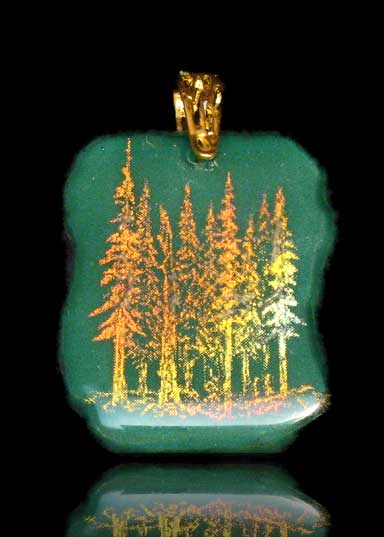

]I feel that the determining factor of crispness of etch on dichro (as animallover seems to want) is the masking accuracy, not the method of etch. Using a photo process creates highly accurate results and ultra crisp lines.
These were created using Armour Etch.
Schooling fish Zentangle (©Shelly Weaver design)
Dichro Forest
Dichro Forest
Brock
Posts: 1519
Location: Vancouver, B.C.
Re: velvet etch
Post by Brock »
Barry, those photos are awful. You literally cannot tell how crisp or fuzzy the lines are, but they appear fuzzy.
I'd get better pictures. I'm familiar with photo processes and I prefer sandblasting.
