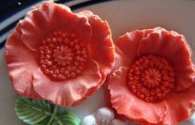

Just what I was looking for! For my first lost wax project what is the best wax to buy? i want to burn it out. It will be a fairly small project - I made a flexible mold and used glass powders but it fell in the kiln =producing a flat blossom -I need to add a little dark paint in the whorl of stamens in the center of the poppies.
I will be using Castalot and need a good wax, would beeswax be best? these are about 2 inches
Thank you
