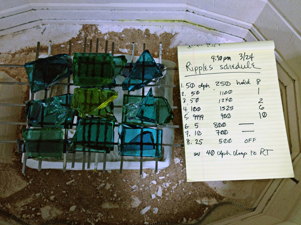

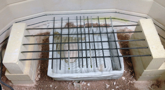

I make my own mesh with a series of stainless steel square stock and a few soft firebrick, and use it when I'm making a blended-color billet, or when I want the colors to blend in a casting.
I drill holes in two pieces of firebrick and insert SS rods to make my "warp," then lay additional rods on top, perpendicular to the first set. I use square stock instead of round to prevent rolling. It's probably not necessary to set the square stock into holes in the firebrick for most projects, but I generally have 15-30 pounds of glass resting on them; I don't want to risk having the glass push the rods away until they potentially fall into the mold (or cause a big mass of glass to PLOP down on the mold all at once, potentially damaging it).
Once I've got the grill base made, I can set up the perpendicular rods any way I want. I place them closer together for more mixing, farther apart for an expanse of solid color. They don't have to be precisely perpendicular, either--sometimes I roughly follow a shape in the mold, so that the rods help guide the glass to the right spot.
The assembly will sag with heat and weight. The glass can move the rods on top a bit, so if I want absolute precision I will wire the rods into place with hi-temp wire. Not usually necessary, though.
It's a very flexible, controllable system. About the worst problem I have is the mess afterwards--the glass that coats the rods will pop off as the kiln cools, making a mess of little shards that need to be cleaned up (carefully, because they're sharp).

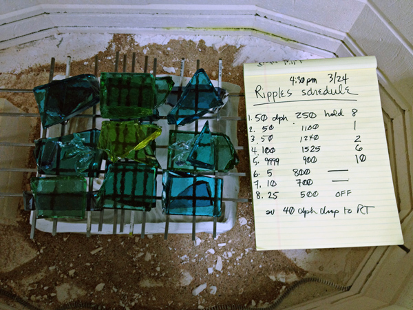

Re: MESH MELT
THank you so very much Cynthia for your enlighting post.
I also improvise on the mesh - make it from 1" thick fiber board, for my purposes this is enough.
I also like your idea of mixing the colours the way you do. Can you please post the finished object? I am very curious to see how it worked... I'd be very grateful for that. I think that the colors blended wonderfully!!
However, I would like to ask few questions
You added the schedule that you used
I understand that this is not mesh melt but casting - is this the explanation for the slow rising of the temprature? as much as I recall, when doing melt you raise the temp. quite quickly - or am I wrong?
The other thing is, that you do not reach the 1700 degrees, and I am asking again, is it because you cast, and not do melt?
But basically you DO melt, so does the slow rise in temp. compensate for the not rising to 1700??
Thanks a lot,
There is so much to be learnt from you.......
very exciting too,
Re: MESH MELT

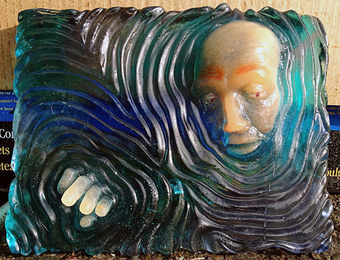

I don't think I've got a photo of the finished piece, but I have one of the glass right after removal from the mold. Unfortunately, you can't see the mixing and transparency very well--it really did combine beautifully. I didn't want obvious interfaces between colors and pretty much got what I wanted. (There's a dark blue line on the box that's propping up the piece, so that's not a solid blue stripe in there)
I always take a photo of the piece going into the kiln, along with the schedule, because as long as I don't lose the photo it's a better record of what was going on. In this case, I'm casting, and it's not really necessary to go higher than 1525F (in fact, I think 1525F is pushing it for casting soda-lime glass). Refractory plaster doesn't hold up well to high heat, so you try to stay as cool as possible.
In this particular case, I'm combining pate de verre (the man's face and hand) with transparent billet casting, something I've been messing around with for awhile. But if I went too high with the pate de verre I'd get some undesirable effects, too, so I'm keeping it low. In fact, the only reason I'm all the way to 1525F (I usually cast around 1485 with soda-lime) is because I do want the colors to mix.
The slow ramp to the top is more for the sake of the plaster than for the glass itself.
lmartine
Posts: 36
Joined: Sat Mar 30, 2013 9:05 am
Re: MESH MELT
Post by lmartine »
This piece is absolutely gorgeous Cynthia! I love it!
Thanks for the tips.
Lucie
Re: MESH MELT
Thanks Cynthia
That very beautiful, as well as interesting! Thank you so much,
For me, there is always something new to be learnt from you [even photographing the schedule with the piece...] I keep a very detailed record of the schedules I use, as well as photos of all the stages of making a piece. The older I get, the more details I document, as I realise , that if and when it is needed, it is very helpfull.
Just as a naughty idea - you could also do revese casting on a piece like this - not with pate de verre - just reverse casting, it could be interesting too.

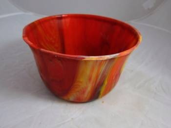

I'm in no way near accomplished as Cynthia. In fact this was my second melt and I decided to try "slumping deep" for the first time.
I still need to clean up the lip.. I'm still learning. I just wanted to say, there's a lot you can do with melts.
Re: MESH MELT
Very nice indeed.
What red did you use to acheive such beautiful red? They warn not to use red, as it becomes 'ugly brown'
Did you go as high as 1700 degrees? did you stay there, for how long??
Also , did you use the 3 molds to get to this deep bowl?, as instructed by Karl???
Or??
Thanks in advance,
S.TImmerman
Posts: 235
Location: San Diego ,Ca
Re: MESH MELT
Post by S.TImmerman »
Havi,
I'm very happy to help (finally) so many have helped me! I made a decision when I'm learning on my own to use 96 Coe as is cheaper. That was cherry opal from system 96, 30% and 20% yellow 50 clear. It was a pot melt and I did go to 1700 for 60 min.
As for the bowl, it was a drop out mold (donut) and I did it twice. The second time for 30 min until it hit the floor and then vented the kiln to 1150.
Hope that helps!!
