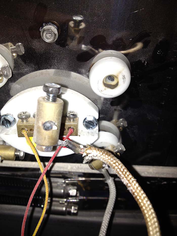

I want to eventually do designs with different colored rods. My New Paragon Caladra kiln quit after the 16th firing and I bought it for Vitrograph to pull canes - i had not set up yet and this happened. it is less than 3 months old that gold colored wire is supposed to be attached to that white ceramic piece.
