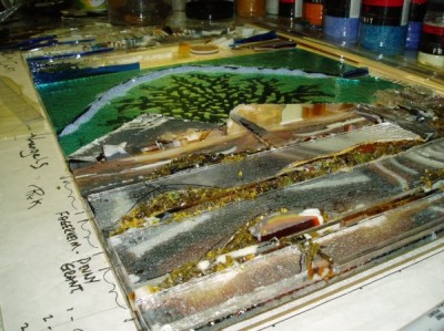

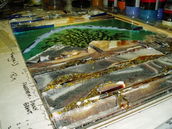

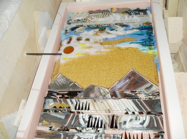

Re: Pattern Bar Slices
Hi! the only parts of the slices that I grind are the parts that have touched the mold or kiln shelf. UNLESS you have used fiber then make sure you grind off all the particles that could make for a scummy join. the glass will not flow as nicely if you have particles exposed. I tooo think the pieces should be as close to the same size or thickness if you are doing geometric but if it is abstract, there are soooo many ways to join or create.
Experiment and have fun with it by adding frit in different sizes and joining with strips that are higher and use clear capping. It is all a journey to your desired end . Have fun.
