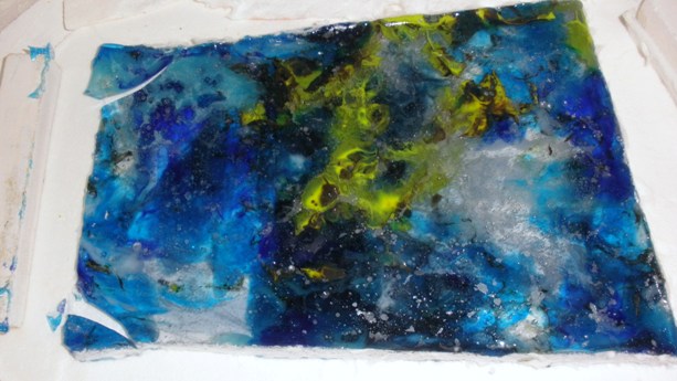

Hi everybody,
I just pulled out of the kiln another glass-boiled piece - and it is broken at the corners. [actually it is the glass from the unsuccessful mesh melt................. I wanted to see what will happen]
The corners are broken, as you can see.
The same happenned with my other attempt to boil glass - it broke, at ther very last mintue when I wanted to move it.
I did the schedule recomoneded - up to 1700, 21/2 hours annealing, ...............
What's wrong? why does this happen??
Can you tell?

Did they stick to the dam? If so that will cause a break.

What Jim said. I don't think this is an uneven kiln problem.
Were you damming the edges of the melt with firebrick? It looks as if the glass stuck to the firebrick at left in the top picture. More likely, the glass hit the firebrick, stuck, and the corners broke off as the glass and brick contracted, probably at different rates. In that scenario, especially if you had glass stuck to firebrick at a 90-degree angle, you'd lose the corner.
I think the second photo goes a fair way to confirming it--you've not only got a corner break (corner crumble, in fact), but you've got a second piece out of the top right side.
Re: WHY did they break?
I think Cynthia's right; on the top photo you can even see glass stuck to your dams.

Many thanks for your illuminating remarks.
I accept them, almost completely.
This indicates to me - that it is right what they say that one should kilwash million times EVERYTHING that touches the glass at this temp. of 1700. That, I did not do. I used dams that were previously kilnfwashed.... and not that many layers of shelf primer.

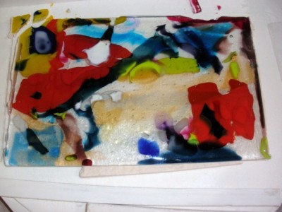

However, at the second piece - the one with the reds - I dammed the left side with shelf primed fiber board. In this case it should not have 'supported' the break in the north corner.... or am I wrong
Additional remark\question , On the first photo, - the blue one - the glass stuck strongly to the fiber sheet [3 m'm] I used underneath it. Is this regular? natural?
Whereas, under the red piece I sprinkled on the fiber sheet some whiting, and it did not stick that strongly....
I am very scared of losing the Dysson shelf - I am afraid that shelf priming wo'nt do its job, thefore I do not risk priming the shelf even million times..... [actually I primed, but them covered it with fiber paper - to be on the safe side]

It is 9 m'm thick. Next experiment I shall put the dams very far, so that it will spread more and become between 3 to 6 m'm thick

It is tough to figure these things out from photos. Certainly, if the glass stuck to a hard shelf, it will not anneal properly. I am still confused about glass sticking to fiber board. I have never seen this cause such a problem, but I have no experience with 1700º firings.
I routinely coat fiber boards and papers with powdered alumina hydrate. I think this works better than whiting (calcium carbonate), especially as hot as 1700ºF. Whiting is good at 1250ºF, but I wouldn't use it when firing hotter than that. Thinking about this, for papers, you could also use EPK. I don't use the EPK (kaolin clay) on my shelving boards because it doesn't fare well with multiple firings, while alumina is quite durable. But the throw away paper would not have that issue. I think EPK costs less. Kilnwash is a mixture of EPK and alumina hydrate.
Common sense tells me that using 2 sheets of thinner fiber paper is better than a single sheet of thicker. So if the inner sheet tears, the outer sheet is not as likely to also tear. I would dip all the paper in to a bucket of alumina hydrate to lubricate all surfaces. You don't have to leave a lot of powder on the paper, whatever sticks is good.
Without looking up the BE schedules, I am not sure what they look like, but my own schedules for 10mm spend 2.4 hours combining the soak and ramp down 100ºF. So, If I understand it this time, I don't think your schedule is out of line.

In this case it's pretty obvious--in that first image the glass stuck to the dam matches the breaks.
Havi, I've found that kilnwash isn't always effective as a release when it's facing really hot glass for prolonged periods of time, as with potmelts. I'll slip a piece of eighth inch fiber paper against the dam for much better protection, too. However, it can sometimes ride up the dam a bit when the glass pushes against it, especially if there is a big, thick mass of glass.
In that case, I overlap the fiber paper. I'll either fold the edge of the paper and tuck it under the dam--I may need to add additional weight on the dam to keep it down--or I'll put the fiber paper against the dams first, make sure they are flat to the kilnshelf. Then I'll cut a piece of fiber paper about a quarter inch larger than the space inside the dams and slide it into that space, clipping the corners to make it fit.
The flat fiber locks the dam paper in place.

So, how would I treat the [would be] bottom of the piece? Thin fire under the glass, AND underneath it fiber paper 1/8" ???
In any case it will not be the primed shelf but something more reliable than that

I've done "boiled" glass at 1700F or a tad above. It's extremely soft and moving, and the kilnwash is pretty much useless. It can make some beautiful patterns, but I concluded that wear and tear on equipment and me wasn't worth it.Havi wrote:Interesting.....................

I don't like using thinfire under hot, moving glass. By the time the glass is flowing the thinfire has burned out and softened and can get pushed around. Occasionally it's gotten trapped in the moving glass.

So what do you use, Cynthia?
3 m'm fiber paper ?
OR ?
I am thinking of using maybe fiber blanket, as I might want to achieve some 'softening' of the glass effect, but then it would be hard to dam it properly , right?

Typically, yes, the thinnest fiber paper I have on hand, which is usually 1/8 inch or 3mm.
