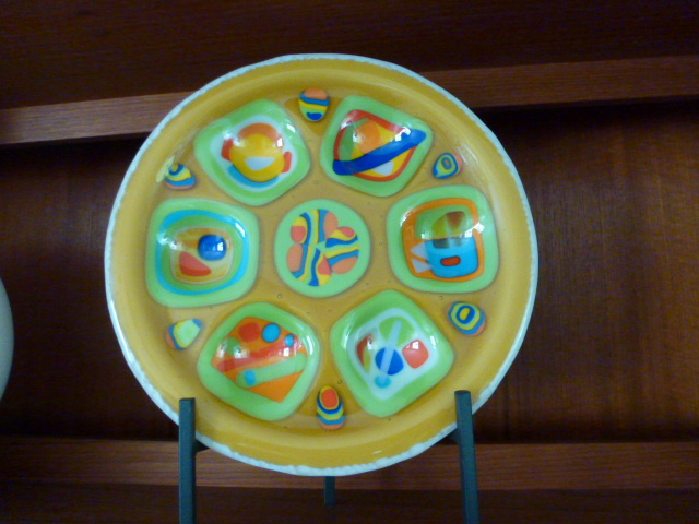

I just took mine out of the kiln. Not sure if I like the design, but it worked. BE glass, slumped at 100 F/hr to 1225 held for 35 minutes. It took a total of 26 hours. Low and very slow seems to work best in my kiln.
The cups dropped about 1/3 inch below the center and the overall height (from top of rim to table) is 1 inch. Thankfully it is stable on the table.

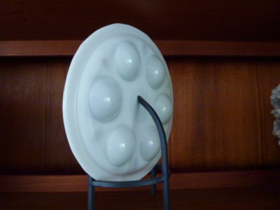

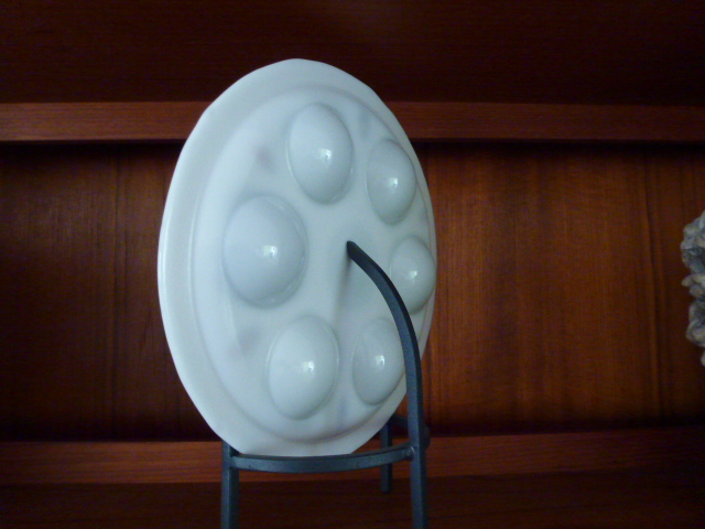

SUCCESS!!!! This was my first slumped project. Zowie! Thank you everyone, for your suggestions, for your encouragement, and for your exchange of ideas, because everything that y'all wrote made me think about the various scenarios.
I had some 2" square conglemerations that were intended to be magnets for my office mates, but they turned out too large. I didn't know what to do with them, and I don't like to waste... So, I decided to try to center them over the seder plate cups (not so easy, even with my tracing because I decided to use a white blank under the amber transparent. I wound up measuring the jockeying the plate until I thought the design lined up with the cup centers. The design pieces had a tiny bit of devit from the original firing (or was it the 2nd firing), so I brushed a layer of Spray A on them. Plus, there will be (unappetizing) food in contact with the glass, so I thought that would add a safe layer. The extra little pieces were cut from a pattern bar (Patty Gray class in Fort Myers) and fused again on their side to add a little interest. The cups are quite well formed. The blanks were 11.5 inches and the finished plat is 11.25" (Did I measure wrong the first time, or did the slumping process drag everying in/down??).The thing weighs a TON - a bissel (little) over 3 lbs.
By the way, it was impossible to see the slumping progress. I finally gave up trying to see if any slumping had occurred. That all means that it may have slumped much sooner and at a lower temperature than I ended up with (40 min. @ 1150, more at 1200, more at 1225, then to 1240, and finally 1250 for 30 minutes). I'll have to make another one to really test the right schedule, but any subsequent tries will NOT have so much glass.
Here are the pix:
Here are the pix:
