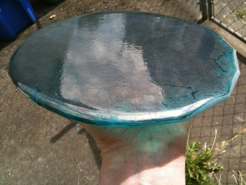

Alexis Dinno
- Posts: 57
- Joined: Sun Dec 13, 2009 9:35 pm
Re: Casting bronze with Glass
The iridescence on the piece in the below photograph results from bronze. The finished piece is quite metalic on one side. Caveat: try not to let the metal touch mold-surfaces as this tarnishes the look.tonyroberts wrote:I've seen a glass casting by Keith Cummings which appeared to be glass with a very high metal content, enough to enable the metal content to be polished. He has examples and a general discussion in his book 'Techniques of Kiln-formed Glass' (pages 95-98).
