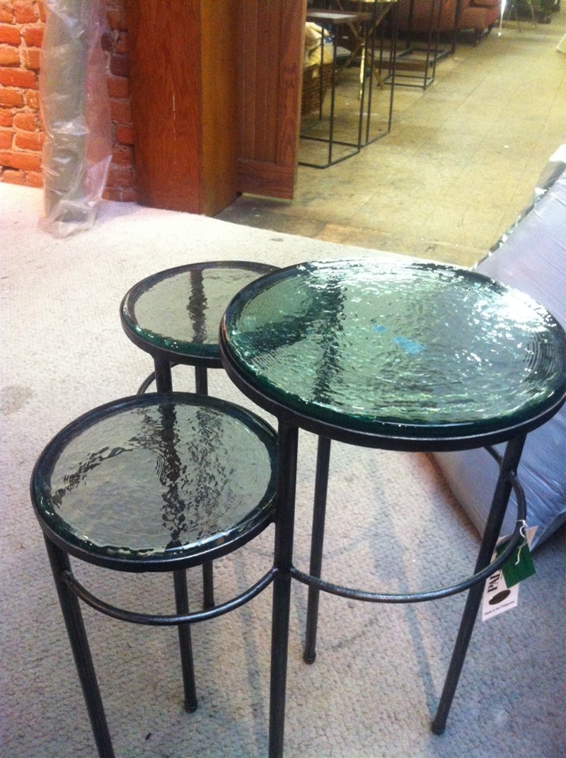

Anyone explain how to make a glass that looks like this...but will only need it to be 1/4" thick.

Looks like it's poured hot into a ring on a marver. Might be tough to make it 1/4" . . .

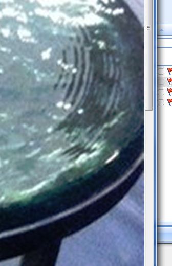

Bert, I wonder if Brock is onto something and there is pouring going on? If you click on the image to see the embiggened versions, you can see finely-nested concentric distortions, which look to me like they result from spreading from a central pour. You can see this in all three, but the largest/rightmost one shows it best in the photo.

That looks like float glass, but definitely has chill marks like poured hot cast glass, like Brock said.
I don't think it's kiln formed at all.
You could however make some similar in the fashion that Bert suggested, you won't however get the rings (chill marks) that may or may not be a good thing.

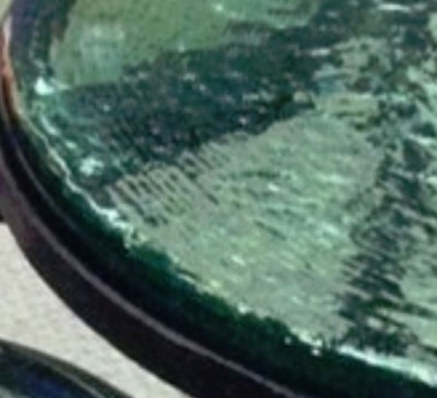

Here are a few blow ups

Rick Wilton wrote:Here are a few blow ups
Yes, but... I can make marks like that with a toothed trowel, if I have something stiffer in my powder mix.
Who do you know who would melt float glass (or even green tinted sodalime) and cast it out on a marver to make a perfect circle? I find that highly unlikely. Creating textures on a circular piece of sheet glass is pretty easy in comparison.

I agree with what you are saying but look at the edges, it's not a perfect circle either. Nor does it look even in thickness.
I agree it would be much easier to make something similar and likely nicer with float, some powder and an beat up edge.
