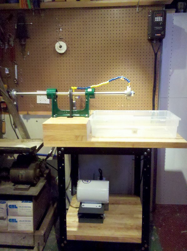

Below are few pictures of the home built glass engraving lathe project I completed last December.
- The arbor assembly, shaft, and pulleys are from Covington. I did swap out the 1" x 23-3/4" TGP shaft for a 36" Stainless Steel Shaft and swapped out the aluminum pulleys for heavier duty cast iron ones with multiple set screws. As a result, there was a little bump over the price shown on the following link (if I remember correctly about a 75.00 bump in total).
http://www.covington-engineering.com/ar ... _open.html
- The 1/8" heavy duty powder coated steel stand assembly was acquired from Rocklar woodworking. This particular stand assembly allows one to customize it by selecting different leg heights and stretchers lengths so to appropriately size it for what one is going to mount on it. Also it comes disassembled so the shipping costs to get it delivered were substantially lower than ordering a unit that was welded together or having to approach a metal fabricator to custom build such a stand.
http://www.rockler.com/product.cfm?page ... te=ROCKLER
- The top mounting platform is 1.75" thick maple butcher block that was cut/stacked/bolted together to raise the standing working height and allow for greater freedom in working around the different sized wheels/drums one might want to use. I watched for discounts/sales at Sears which resulted in a lower than list price and since I was able to pick it at the local Sears, no shipping cost.
http://www.sears.com/john-boos-1-3-4-in ... ockType=G1
- The motor I used was actually a new surplus Baldor 1-HP 1725 RPM 3-Phased continuous duty TENV washdown rated motor I picked up off of ebay for a fraction of the cost of retail.
http://www.ebay.com/itm/310255735502?ss ... 1423.l2649
The motor mount to allow for variable belt tensioning was purchased from Grainger. I wanted the motor mounted below the arbor and close to the floor so as to cut down on transfer vibration to the shaft and keep the center of gravity low so the unit was not top heavy.
http://www.grainger.com/Grainger/DAYTON ... Pid=search

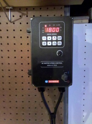

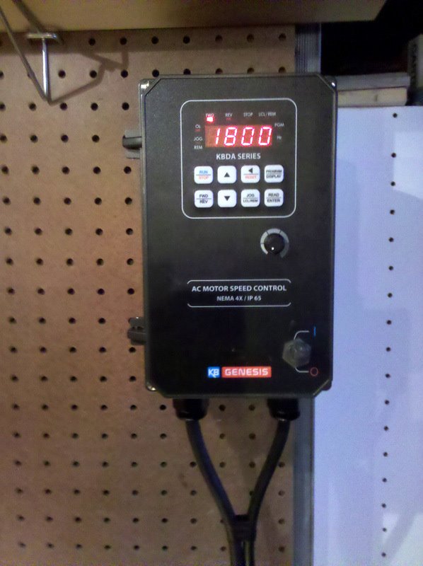

- For motor speed control and to convert from single phase to 3-phase, I used KB Electronics Variable Frequency motor drive (KBDA-24D). It allows one to really dial in the speed the wheels are turning at.
http://motorsandcontrol.com/products/kb ... -gray.html
All-in-all the cost to build the lathe came in around $1300.00 including shipping/handling of the various components. Now this is right around where the turn-key offerings (arbor, shaft, mounting surface, motor, pulleys, etc) from Covington are at so why did I bother building my own?

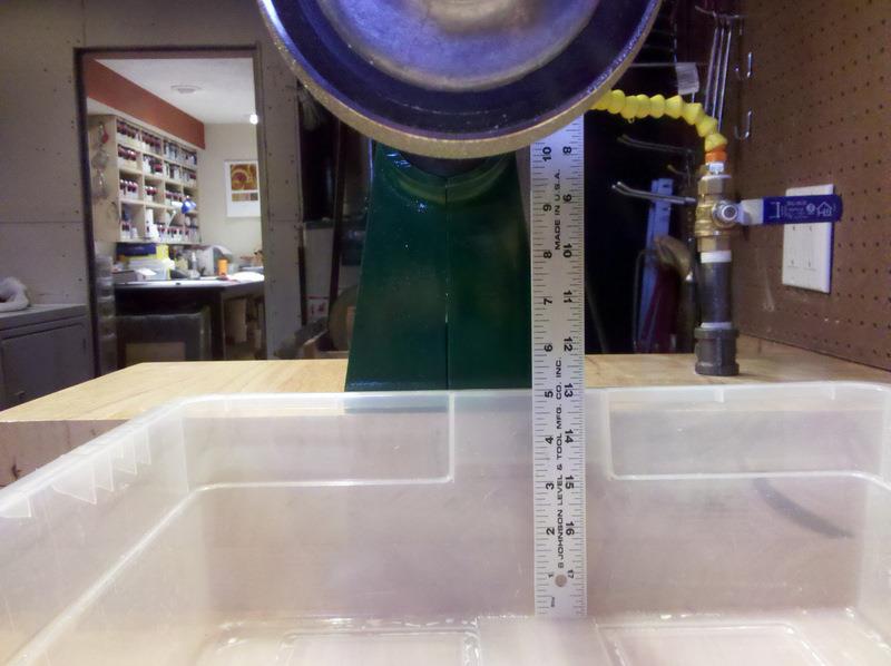

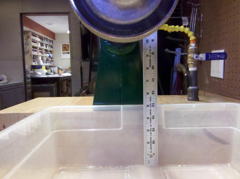

I needed this unit to fit in a particular space with the flexibility of being able to move it around and there were certain things about the Covington turn-key offerings that I thought could be improved upon (motor/arbor mounting so as to reduce run-out chatter at the shaft end, greater freedom of access when working around wheels/drums themselves, the ability to vary the speed past 3 fixed settings).
Definitely didn’t have the money (or room) for a Spatzier or Jim 9000 so tried to build a unit that would run as true and chatter free as possible without breaking the bank and also while using easily acquired components.
I am quite happy with the result. While it will never be in the same league as a Spatzier or Jim 9000, the unit is incredibly smooth running with the flexibility I was looking for and will work well until such a time my skills at glass engraving can truly justify a machine of that caliber.
