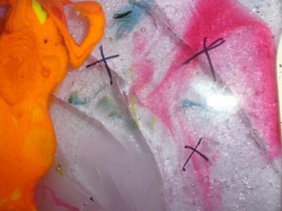

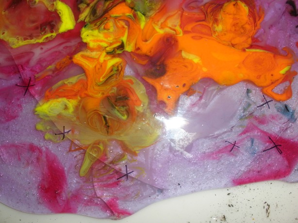

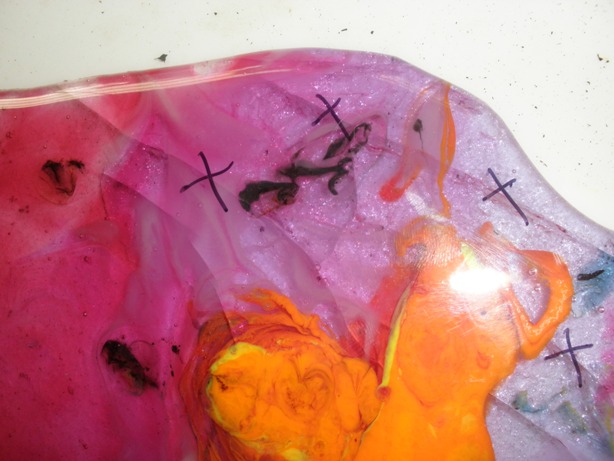

Dear friends,
This time I attach close ups of the cracked areas in this work. I'd be more than grateful if anybody could explain why it happenned.
I refired the piece ,after the first cracks - I did a very conservative schedule.
It was absolutely OK when I took is out of the kiln Friday night.
Sunday morning I saw the cracks.
I shall try 'rescue' this by sawing away the bad areas. - if it stops cracking, then see what can be done with this .
All the glass is BE, the lavender background is BE1842 light neo-lavender shift tint - color which I like a lot. I just want to know whether I should not use it at all, or what?
Thanks in advance,
Thanks in advance,

I would not use this. It will only continue to self destruct. These pot melts/screen melts/high fires are experimental at best. With COE shifts and other complications they are often unreliable!
- Posts: 1542
Re: It cracked AGAIN!
Most likely, this is incompatibility caused by prolonged hold at high temps (1700F/925C). Many Bullseye and Spectrum colors will shift COE after long soaks at high temps.

OK guys, DEAR guys,
I am very grateful for your responses. Honestly, many many thanks!
By now, this melt is sawn and the 'sick' areas are out! I shall see how the 'healthy' part will survive.
The point is, that this method is very representative of my emotions and being , and I would really love to develop it - if the glass allows me to -
I have patience. And shall continue experimenting,
My next firing will be on my Jen Ken kiln, which is a bit bigger -
I shall go only to 1600F as top temp. I have seen it recommended somewhere. Also I shall do a very slow annealling, both at soak and at the going down process.
However, do you rule out that this is because of the specific glass BE1842?
Eventually I shall experiment with this again, but if someone has particular knowledge about this it will be very helpfull.
Thanks a lot,
