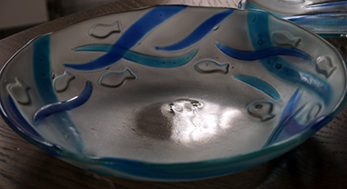

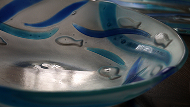

Hello, first happy new year to everyone!
I'm a newbie, and I made only very few experiments with fusing and slumping. While my fused pieces come out as I expected them, I have some problem with slumping. I always (3 times so far :-)) get a matte surface where the glass deformed. In the center of the pieces the surface stayed shiny. I fired twice these pieces, first I full fused them at the 1510 degree process temp. The second firing was for slumping, at 1200 degree. All 3 pieces had the same problem, no matter how thick it was the glass or how fast or slow was the firing speed. The matte surface is not even, but stayed glossy where the glass is "higher" - above bubbles, and waves as you can see on the photos.
I'm not sure if it's devit or not. I think it is not, because the whole slumping process was below the devit zone. The most interesting thing for me is that I put another pice for slumping while a tack fusing programme was going on. This piece was already a waste because of other reasons, and I was just curious what it's gonna do in the kiln. As for 5 layer tack fuse the program was quite slow with a 1410 degree process temperature. It slumped and its surface stayed clean and shiny.
Any idea what it can be and how to avoid this matte surface? Shall I go as high as 1400 just for slumping??
Thanks for any clue

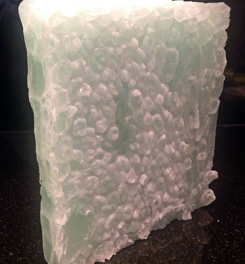

Re: Matte slumped pieces

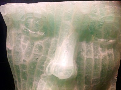

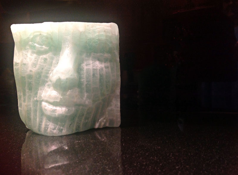

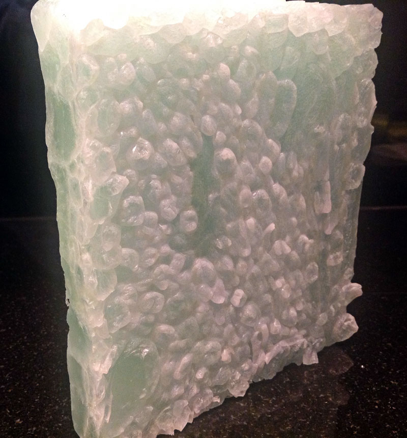

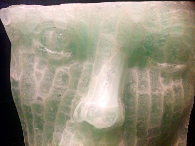

Devit is simply crystallization of the glass. Glass is, well, glass, because the molecules in molten glass don't have any bits to clump onto (nucleation sites) while cooling, which would start them forming orderly arrays (crystals), and glassmakers ensure that the glass cools too quickly to allow the molecules to move into those orderly arrays. The cause of devit can be mechanical, chemical OR thermal--there really isn't a set temperature at which glass is guaranteed to devit, but if you hold it in a soft-not-flowing state long enough you're certainly increasing the probability that it'll devit like crazy. Presumably you can prevent devit by doing the opposite, but I'm finding that in float, devit tendency is very glass-dependent. The schedule that eliminates devit in one glass has absolutely no effect on another.
I've had 6mm float that doesn't show any devit at all, but it's rare. It could be that the float formulated especially for fusing is more devit-resistant, dunno, never tried it. I can sometimes predict the tendency to devit by the shade of the glass on edge--aquamarine glass seems less devit-prone than strong iron greens. Unfortunately, because my float is all salvage, I have no idea who makes the "good" glass or its composition.
Borax glazes may prevent devit but they can also cause more problems than they solve. Uneven application can create blotches that look worse than the devit, and if the solution lands on a kilnshelf or mold it can fuse to it--I tore divots out of one of my favorite slumping molds that way (and put divots in the glass where it fused to the mold through the kilnwash).
I wanted devit for this piece to ensure strong outlines of the rows of glass. (And actually got more than I bargained for--this was a beveled glass shelf in a gorgeous, very green tempered glass, and I arranged the crumbles in very precise rows--it's devitted so far into those rows that it's lost a lot of transparency). I set up a casting schedule that included a 6-hour hold at 1600F, and a ramped anneal over 20 hours that started at 1050F and went down to 960F (the piece is 4 inches thick at the nose). Tempered crumbles make for lots of sharp edges and surface area (good nucleation opportunities). The front shows how the devit followed the rows of glass; the back shows the crystallization on the tempered crumbles, which was extreme. I very much like the effect, but I'm going to coldwork down the sides to see how far it takes to get to the transparent glass.
