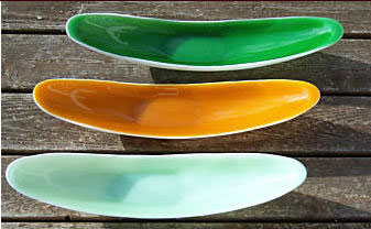

A long time ago I saw these glass bowls, and fell in love with the shape. Did contact the artist in case he/she wanted to share where to get the mold, but reply was that it was a found object.
Haven't been lucky to find something as nice as those, so thought would try shape below:
