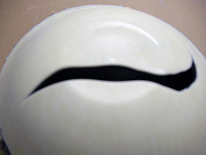

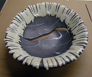

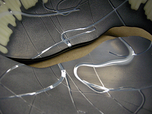

Third failure with this configuration
12" diameter using a 11" diameter bowl mold. I am using a smaller mold to create overhangs that create a handle effect.
The bottom is french vanilla, top is steel blue with nougat rods around the edge and white vitrigraph
Fusing Schedule:
300 to 1050
50 to 1250
250 to 1450 hold 10 minutes
800 to 960 hold 3 hours (went back to Bullseye original temp)
100 to 700 off
Waited until room temp to remove
Slump Schedule:
100 to 1150 hold 3 hours - Slowed down 50 degrees this time use to do 150
100 to 700 off
Have what I describe as a tear in the piece. Edges are smooth to the touch at the tear. Should I just forget this idea or should I slow way down. The tear happens on the slump
Should also mention that I have a shallow kiln and the elements are in the top and the piece sits close to the elements.
Is this configuration doomed?
Fusing Schedule:
300 to 1050
50 to 1250
100 to 700 off
Slump Schedule:
100 to 700 off

Re: Failure
Slow down to 50 deg. per hour. Perhaps this will help OR fire you pieces then bring somewhere else to slump that is not close to the elements. You are for sure thermal shocking you piece. Can you slump in shallower vessel form. Les
Re: Failure
Also, the T-grade rods aren't recommended for kiln forming.

Re: Failure
Hi again, it sure looks as if it is a thermal shock because how it has healed almost and softened edges. It broke going up. I toooo use the almond rods and they give a lovely reactive quality with the dense white (which must be fired lower!) but I always go very slow when slumping, and especially if close to elements. Slow right down to 50 deg. per hour, right up until desired slump probably at 1100 to 1150 F.
Sincerely, Les (just my suggestion but has worked for me for many years now)
P.S. I also might suggest to slow down from Anneal to 700 F. as well as 100 is to quick . What do others think.
- Posts: 215
Re: Failure
Hi Jennifer,
Spectacular tear in the glass. I agree with the comments that it is thermal shock and that it happened on the way up.
I'd like to speculate on several reasons why it shocked. The bottom is french vanilla which is a very stiff glass. The top is steel blue which , because of the dark colour, is probably much softer than the FV. The steel blue will absorb heat much more quickly than the FV because dark colours absorb heat more quickly than light colours .... kind of like how dark clothing absorbs heat more than light clothing which reflects it. Plus the steel blue is directly exposed to the lid elements which are quite close according to your description. The glass is lying on the rim of a mould and the air trapped inside the mould is cooler than the air in the rest of the kiln . So the FV underside is not "seeing" much of the heat. The steel blue really wants to expand whereas the FV is lagging behind. That led to the thermal shock.
Interestingly, when I looked at other pieces on your web site ( very nice work btw) you have successfully slumped steel blue bowls and I am assuming the backs are FV ("No. 1" seems to have a very light back). So why are the pieces in your current design more prone to thermal shock? I wonder if it has something to do with the light coloured rods on the rim. The tear in the glass is only in the steel blue. It ends at the light coloured rim. I am assuming that they will be stiffer than the steel and will be reflecting heat while the steel blue is absorbing heat. This may add stress in addition to the stress from having a colour/ viscosity difference between the top and bottom of the piece, and being close to the elements.
So ... is the variation in viscosity between the rim and the interior resulting from the design creating too much stress within the piece? I have made pieces with a FV rim and steel blue interior and had them work. The three differences in my set up were that the glass was only 1/8 inch thick (easier to get heat into the interior), the FV was only around the rim (not on the back), and I had good separation between the glass and the elements.
Your ramp rate of 100f/hr is very conservative. The only suggestions I can make is, as Les suggested, slow down the ramp and maybe add a few soaks while heating through the brittle zone to increase the likelihood of getting heat even throughout the piece... not only from top to bottom but from edge to center. Soak it for 30 minutes say at 400F, 600F and maybe even 750F. I would still use a very slow ramp between soaks.
It is unfortunate to have had problems with the piece but what a great learning piece. Hope this helps.
Cheers,
