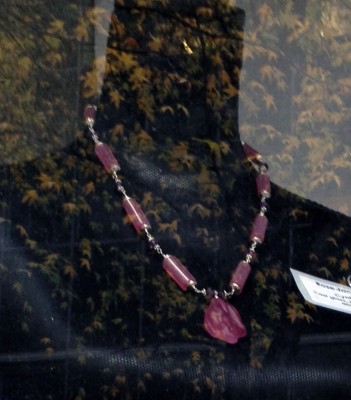

I like to make my own chain when I'm incorporating my cast pendants into necklaces, and the hollows are nice because they've got a built-in hole for the wire to go through. Cap each end, terminate the wire on both sides with loops, and you've got a nice link for your chain. Unfortunately, I've only got a really bad photo of one, but here 'tis:
I took Nathan Sandberg's Venetian cane pulling class (it's an amazing (and very fun) class, if you get a chance to take it, you should), and was horrified to find most of the students' hollow cane going into the trash. I asked permission to dumpster dive for it and came away with an absolutely glorious collection, enough for a dozen necklaces. ;-)
bob proulx
Posts: 186
Re: Glass Straws
Post by bob proulx »
Very nice necklace.

Thanks very much for your detailed explanation. I really appreciate it! Very nice necklace!
