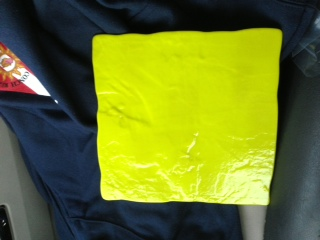

Hi All:
So I made a nice stacked plate which I am happy with except for the back of it. (trying to load the pix here...although technically challanged). I did not fuse the plate myself, but left it at the studio where I volunteer in order to use some of their tools (strip cutter and tile saw). The back of the plate is all lumpy and uneven. My gut feeling tells me that either the thinfire paper got crumpled underneath the plate or that they did not clean out the kiln from the previous firing and there was thinfire powder in little piles all over the place, on which they placed my plate.
Regardless, how do I fix this? Can I put it back into the kiln and just take up (slowly I know because it is thicker now) to a full fuse. I would now do this myself and make sure that the kiln shelf and or thinfire paper would be flat so there should be no texture. If I do this, would it be the design side up as if it were the first fusing? Another idea I had was to put a sheet of clear on it and then fuse it but without damming it, it would spread a little and I would lose my stacked design.
Thoughts, suggestions, all welcome.
Rachel

- back stacked plate - rlm.png (120.42 KiB) Viewed 24282 times

I usually see those kinds of divots when part of the kilnwash has flaked off the shelf and instead of scraping it clean someone just slaps on new layers of kilnwash. The new wash tends to absorb into the areas with no kilnwash while it simply builds on the rest, so it kind of exaggerates the divots. It'll telegraph to the glass surface even through thinfire.

Your gut feeling's probably right. The shelf wasn't smooth when it was fired. It's also possible that the piece was fired very quickly and there was some trapped air between the piece and the shelf.RachelM wrote: My gut feeling tells me that either the thinfire paper got crumpled underneath the plate or that they did not clean out the kiln from the previous firing and there was thinfire powder in little piles all over the place, on which they placed my plate.
You're on the right tack. Just refire on a smooth shelf or on thinfire. Design side up, just as with the first firing. And of course a bit slower because the piece is now thicker.Regardless, how do I fix this? Can I put it back into the kiln and just take up (slowly I know because it is thicker now) to a full fuse. I would now do this myself and make sure that the kiln shelf and or thinfire paper would be flat so there should be no texture. If I do this, would it be the design side up as if it were the first fusing?

Thanks again! I am re-fusing tonight.

Hi ALL!
~ ~ ~ MISSION ACCOMPLISHED ~ ~ ~
Back of plate is now smooth and looks a helluva lot better!!!
Rachel
