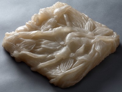

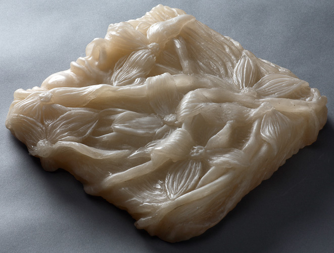

Thank you very much for all of that information. A few months ago I did purchase the book ' Coldworking glass without machines' but there was no real indication of time it takes from my reading. I am curious when you mentioned sealing the glass what you did to seal it. And the photo you put on is beautiful, I am thinking you had to sand this first and then slump or cast? I really like the finish you have on it. But if you slumped or cast after sanding then it would pick up mold texture...? Looks very pretty! And a lot of work. I think I will try a small piece with the wet dry sand paper. Since I don't have 400 grit diamond pads would it work to go from diamond pad to wet dry paper? I love your work, Thank You very much for your help...Delberta

Well, as I said, I measure hand-sanding time by movie, and a movie is anywhere from 1.5 to 2 hours or so. So a two-movie piece probably took 4 hours.
The piece in the photo is cast using the pate de verre process with powder on the surface. Powdered glass in a damp mold tends to result in a mild scum/devit that requires smoothing off, i.e., a light sanding. On this particular piece I had some mild flashing, and I do typically use sculpture tools for that (i.e., a Foredom grinder with 200-grit diamond bits). The hand-sanding process is both to remove the scum and equalize the ground surface with the rest of the piece, and that's the part that took two hours.
But honestly, it's really difficult to say how long it will take. It depends on the size of the piece, the condition when you start, the type of surface you're looking for and how perfect you need it to be, the grits you're using (I find it's generally faster to gradually step down grit sizes in sequence than to jump a couple hundred grit in one go), and your own technique.
On the sealer, you'll find a lot about this if you search the archives. I use one discovered by Jeff Wright, Unelko's shower sealer gel. You rub a very little of it onto the piece with a lint-free rag and work it in. It'll start out with a glossy shine that fades into a softer finish in a couple of weeks. It brings the color back to the glass without needing constant renewal.
