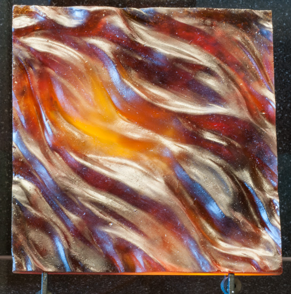

Also, if you're making a lot of these tiles, it's probably easier to create a positive in very flexible silicone (look for a silicone with a "Shore A" rating of 30 or 40), secure that to your base and make your mold on that. The silicone will release easily, literally peeling out once the mold has hardened, and can be used over and over. You could make a basic flat tile that way, add whatever decoration you want in wax on top, and case molds with lots of variations using this method. It's what I do to create tiles like this: But to answer your questions:
