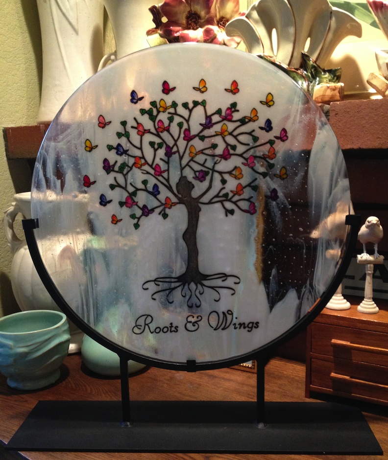

I did a job recently where I needed to match the client's logo, which had extremely vibrant colors. After lots of experimenting, I ended up using Pebeo Paints. I cured them in the kiln but they mature at 350°so your neighbor can work at home and free up your kiln for your work.
