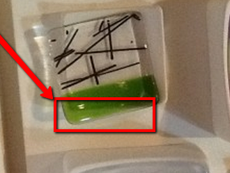

Hi (again....am I asking too many questions?)
Can anyone tell me why a piece of glass moves off the center of the mold during slumping?
See photo below
There were 4 squares in the kiln
Two 3x 3
Two 4 x 4
The smaller ones both moved off center
The larger ones remained fully on the molds
Thank you
Susan

Did it actually move to that position during the slump? Or perhaps after? I guess I'd want to know: Did the overhanging edge that's now off the mold slump so that it's hanging down? It's hard for me to tell, but it doesn't look like it did.

I'd also like to see a photo of that stringer piece outside the kiln- it's hard to tell if it slumped wonky or if it's just displaced.

I'm interested in the area highlighted in this screenshot: Did it fall over/slump over the edge of the mold? Or has the piece slumped ok, but it has just been moved/offset in the mold at some point after the actual slump was completed?

I was wondering that too David..... Looks like it was jarred after done slumping. The edge looks as if slumped perfectly and is not bent over the edge. Susan?

David...i do not know exactly when it moved because I did not open the kiln until it cooled down. it was in that position when I gently opened the kiln. but i think it happened during the slump and not during the cooling

David...the section you outlined in orange...the area slumped over the shape of the mold, off center. it must have happened sometime during the slump, before the cooling.
Laurie...piece is not slumped perfectly., to use Marty's term, it's a wonky slump. and yes, both 3 X 3s moved off the mold.
