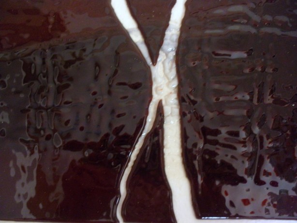

1. Took a rectangular 3 m'm piece of fiber. Drew on it a triangle and sprinkled it with powder. Wet it as necessary, broke it, as necessary - in order to make the crackles. then put on top of it a rectangular piece of glass.
it Broke
Is it a thermal shock?? :? , but I followed the firing instructions... or is it because only part of the fiber paper was covered with powder?

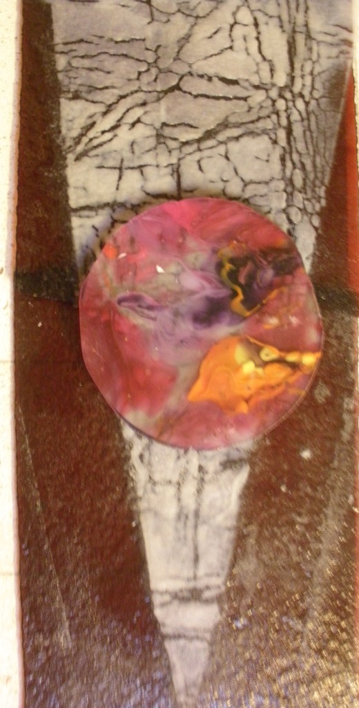

2. Upon cleaning the crackled face, I realised that actually it could be fused like this. Of course cleaned and handled peoperly. And then, fuse the melt on top of it....
What do you think?

Refusing with the melt is always risky...sometimes it works...sometimes they break.. The high temp. used to produce the melt sometimes will shift it's COE..thus additional fusing is not an exact science.In my experience working with melts should be considered experimental..don't bet on the results.. but enjoy the ride!

Hi Havi.
How thick was the powder in the triangular crackle section? If I am understanding the description of your layup, and depending upon your initial firing speed, the uneven thickness of the glass could have contributed to the break. My approach would be to apply powder to the entire rectangle of fiber. You can define the contrasting triangle using color and crackle just the area you want crackled, then cap the powder bed with the clear rectangle. This will give you a more even base to work with.
I think adding the melt on top of the crackle will be a trickier firing, depending upon the thickness of the melt. You will need to be careful with your schedule to compensate for the uneven thickness and to anneal properly. Melts are tricky sometimes to incorporate into crackle and you can't count on 100% success rate, but when it works it can be stunning.

The powder was not too thick, about 2 m'm, and your idea, Sharol must be right. I should have used transparent powder on the areas not meant to be covered with crackles. A bit hesitant, though, as I have bad experience, sometimes too much transparent powder becomes white. I'll have to think about it. A colleague of mine here suggested that the explosion was because of the dark color of the glass, he says I should have used clear transparent.
Yet, by now I was lucky to have 2 pieces where the 'melt' was properly fused into the glass. In one case it was full fuse, in the other it was tack fuse. Actually there is a third one which was conour fused [I should have stopped the process earlier, I was aiming at tack fuse, but this was really just an experiment]
The melt is 6 m'm thick. Those that worked for me were fused in a very very conservative schedule 30 dph Celsius [54F] up to 540 Celsius [I'll translate it to farnheit later] [1004 F] .the whole firing took 40 hours....

What color was the crackle? I work with Bullseye glass and my experience is that the white is so much stiffer than the dark colors that it has caused cracks like the one you describe. The 0013 is especially hard and refuses to move causing cracks when put with a softer glass. The 0113 is a bit better(not quite as stiff). But I think your local friend gave you good advice. Try again with a piece of clear or thin clear between the white and the dark color and use the white that is less stiff (0113). Very creative pieces BTW. -Lori

When it comes to cracking glass, stresses are cumulative. So a little compatibility stress, coupled with a little poor annealing stress, coupled with a little heat shock, can add up to a crack. Stresses can also be mitigating, when one causes tension and another counteracts with compression. The practical mitigation is always to slow down and lessen the heat shock factor, which is the one you have immediate control over.

Thanks for chiming in - the crackle was BE 0034 [which is also kind of off white] and the dark one was carnelian. So I think you must be right in your analysis of the situation. Tonight I am trying to re-fuse the carnelian 2 big pieces and unite them to one whole piece.
