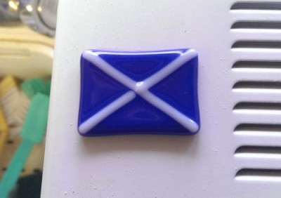

I'm trying to may glass flags and I have managed to get the St Patrics and St Georges cross without too much of a problem, the Union Jack took a couple of swings, but the St Andrews cross is not playing nicely after my 11th try.
Basically the stringers separate in the middle like this:
- Separation
My thinking is that the blue heats faster and more so in the corners (nearer the edge of my microwave kiln) so the corners tack first and then the stringer shrinks away from the looser edge in the middle.
Originally I just laid the pieces as close as possible (glastac glue or cyano to hold)
I tried balancing the bits in one direction on the edge of the other bit (they both fell off)
I tried to get 2 full length pieces to balance, but everything moved
I tried shaping the pieces to balance better, but the thinner glass heated faster (as expected) but just shrunk away without attaching.
I tried overlaying 1 longer over the bit in the middle (that's the photo above) (it always seems to be too sort or falls off)
I tried using a clear glass prop, but because I want a texture, not a full fuse the clear has texture as well.
If I had a lamp, I'd probably look to heat the middle of one bit so it bends so I can put it in the kiln without anything moving, but I don't have a lamp, and the moving flame would probably cause the fixed bit to move as well.
Is there anything like solder flux I can add to the bit of glass so it heats up faster?
Or any other ideas on how I can make this a little more consistent and complete my series without loosing any more hair
Thanks in advance
Nigel

Well, happy news and sad news.
Sad news: for some reason two attempts suffered from devit. 3rd bit from the same glass that didn't have devit ever before the last 2 is cooling now... hopefully clean.
Happy news: Maguyvered an old zippo filling it with meths + stringer = bent stringers
I wish I could get the join flatter with a contour fuse, but it worked and I have a St Andrews flag finally... well, I will have in n hour
thanks for all your help guys
