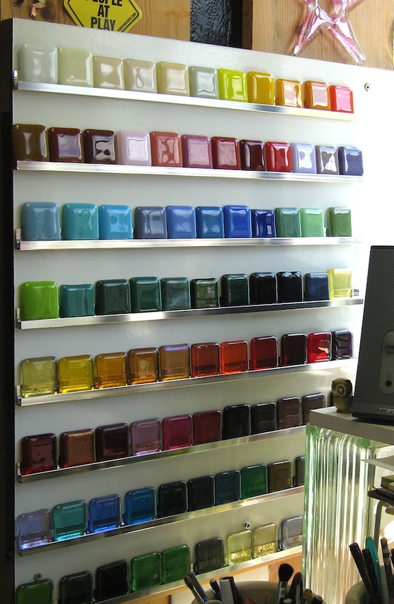

Re: Test tile firing schedule
I posted this in another thread; these are my 1.5" color reference tiles, mounted with mirror strips:

This is what I meant by a chart! Yeah Valerie! If I put them in a bucket I would never refer to them.
I also have some wood panels that I use e6000 to adhere the glass and write directly on the wood........but I like the way Valeries is even better!
Yep, all of my samples are created this way. What I especially like about the rail system is that they're removable, so I can group them, compare them, etc. These are my most-used samples (at least for this week!) I have several other tiles, including my special production colors, in small trays like photo slides are stored in.Morganica wrote:If you are making test tiles, fire them with your most frequently used schedule (or the schedule you're planning to use on the piece you're testing for) at least on the up ramp and process temp.
Maybe 'rail system' is a bit of an exaggeration! I bought the strips at the hardware store; they're made to hang large mirrors. Nailed them to a bright white board and screwed the whole thing to my glass storage shelves. The rails are large enough to accommodate two-layer tiles. Mine measure 1.5" (more or less).Susanbuckler wrote:Valerie
