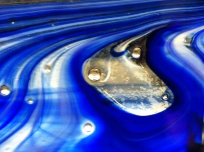

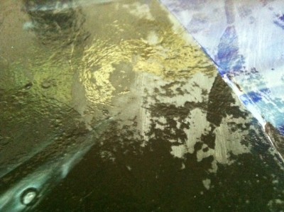

This was my fourth time firing and I'm trying to familiarize myself with the full fuse fire schedule and figure out how big of a piece I could fire in the kiln. I tried to keep it simple and use as much uncut glass as possible, so there were 4 - 12" x 12" tiles and 2 - 12" x 3.5" panels on either end. The tiles with more opal were on top, more translucent on the bottom.
Problems:
Bubbles that were about 3/8" diameter. I washed with soap and water, maybe I didn't rinse well enough.
Unsure if the surface finish/texture on the back of the glass is normal or if I can remedy the situation.

It is hard for me to tell from the pictures if there is devit......i do however see the bubbles.
I can't read your schedule unless it is translated to F. So I am no help there.....
Did you do a bubble squeeze? Spectrum glass is so flat you should not be getting these bubbles if fired correctly.

baroque isn't flat. Air bubbles are likely.

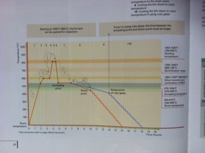

Sorry about that, I got the schedule from "Warm Glass: A Complete Guide to Kiln-Forming Techniques". They don't specify a 'bubble squeeze' phase, I hadn't seen it mentioned until I came to warmglass and I just figured I'd try the schedule from the book first.

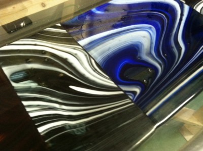

As far as the Spectrum; one of the sides was definitely more contoured, it follows the streaky part of the glass. I stacked the layers with the smooth sides together, which I had assumed was the correct method, not for sure though.

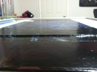

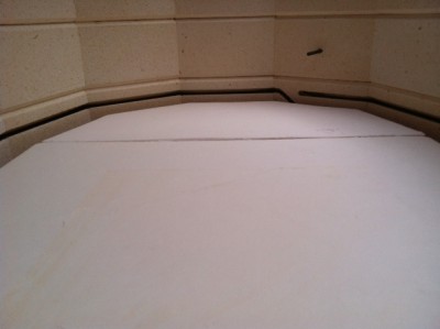

It might be worth mentioning that I have to use three different sections make up my shelf and the entire surface wasn't flat. I didn't notice until afterwards, but it caused a 1/8" ridge to rise on the bottom of the glass, very near to where there is a concentration of bubbles.

Joel....The only way to fire across a 3 section kiln like that and not have a ridge is to either
Get a full board of fiber board and cut it to the size of your kiln
Use a blanket like I think Bert does
or avoid the cracks

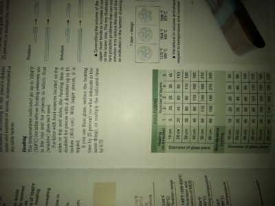

I'm pretty sure the conversion is correct, sorry about the formatting. I'll attach a pic of the chart i used, hopefully it's readable. There was an additional chart to add time for larger pieces, etc., so I probably just misinterpreted or miscalculated something. Of course Cent isn't my native language either, so theres always that.
Thanks for your help, I think i'm going to find a reference for a schedule on warmglass and keep the size of the work small enough to fit on the shelf.

Also be aware that Spectrum's Baroque is not always compatible, not even with itself, as there are viscosity issues on top of the COE.

Joel- I made several strip cut pieces out of baroque a long time ago after testing the sheets against themselves and each other (and finding no COE distortion with polarized lenses). One of those is slowly coming apart in my studio. The others got sold but no one's complained yet- I fully expect to have to refund their purchase price if they find me.

pretty logical when you think about it and the huge thickness differences between the clear and the colour. The only way to get them is by using viscosity which is one component of the compatibility conundrum.

You don't indicate how thick the tiles were at the start - maybe one layer?Joel Taylor wrote:This was my fourth time firing and I'm trying to familiarize myself with the full fuse fire schedule and figure out how big of a piece I could fire in the kiln. I tried to keep it simple and use as much uncut glass as possible, so there were 4 - 12" x 12" tiles and 2 - 12" x 3.5" panels on either end. The tiles with more opal were on top, more translucent on the bottom.

You initial rate of advance is much slower than needed. You could go at 220C/hr (for up to 6mm thick) to a bubble squeeze around 630-650 (for S96).
795C or 800C is high enough for Spectrum. Your bubbles may come from thin or over-fired glass or both.
In the days when I messed around with spectrum, I found baroque very prone to devit.
