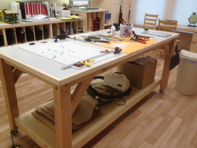

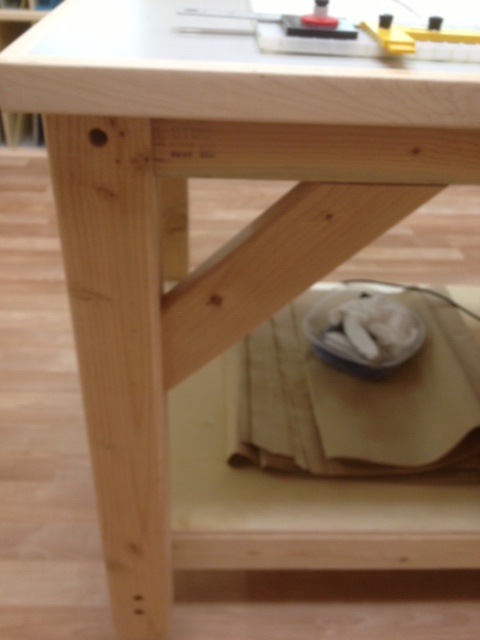

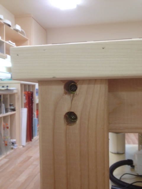

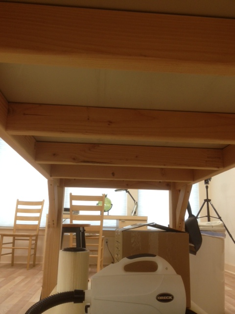

Post by David Jenkins »
I made a work table that's working well for me. Dimensions of the top are 38' x 86'. The work surface is 38" off the floor, which is about 6" below my elbow height. I had previously been told that the optimum height would be 3" below elbow height, but that didn't let me lean over the work surface as easily as the 6" did. YMMV.
The top is made from a sheet of melamine board that was left over from previous previous work in the house. I put the whole thing on locking casters, but in retrospect that was probably unnecessary - so far, I've never had to move it. (Weighs a ton, though, so the casters may yet come in handy.)

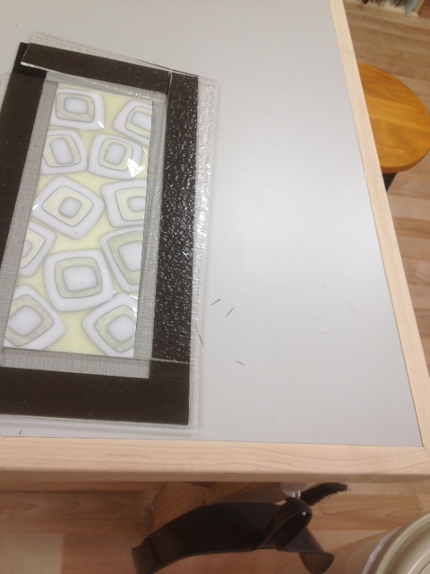

David Jenkins
Posts: 174
Location: Cypress, Texas
Re: Workbench?
Couple of more pictures:
