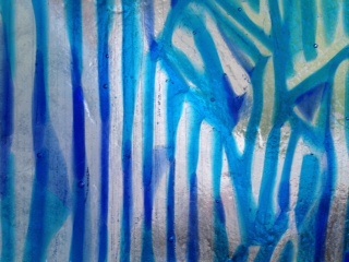

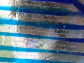

Hello,
I ask your advice.
I did strip work , with a lot of clear strip (spectrum 96) full fuse
In the place were two clear strips next each other
I can see the connect line .( I hope you can see it in the image.)
I want to get one "clear" unit
How can avoid it next time,
Can it be fix , in this work
All the best
Osnat
Clear border
Clear border

Cut the clear strips ¼" wide and lay them on top of each other, flat.

Re: Clear border
You open my mind. So simple .Thank you.
How to wipe out those line?
