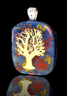

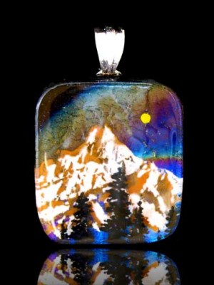

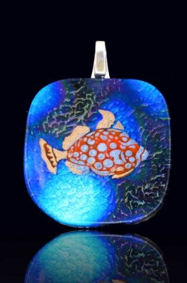

Several comments on screen printing.
First, to simplify what was said before, screen printing is an additive process. Unless you are using transparent colors (with which I have no experience), you cannot create multiple colors by separating and then combining.
However, here is a trick that we use a lot. Brush paint the screen with different colors, then pull the final color on the screen. Whatever color went on first is what will show. You have to be very careful with the quantity of ink brushed on or you will get smearing of colors.
Here are some examples.
- Grumpy 4
- Fall Colors w/tree
- Mt. Baker-night

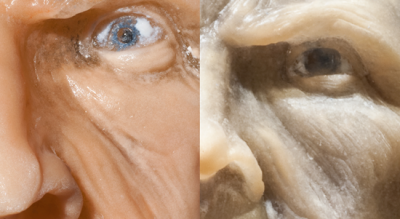

They're right; any color you can mix in watercolor or acrylic you can probably reproduce with frit. I think I'm up to something like 7,300 pate de verre color samples, some as frit tints, some as layer sequences. It can become very complex--some of my pate de verre portraits have 30+ (really thin) color layers. I've been amazed at how different the samples look when I change the order or leave out a layer. Here's an example: In the first image, layer 5 is a thin sifting of Pimento Red, and the transparent deep plum sifting (shades the eyes and deepens the folds in the wrinkles) is at layer 14. In the second, they're reversed--everything else is the same. Notice that not only does the fleshtone change, but because pimento is an opaque glass, the light stops much sooner, too.
This is what happens when I leave both the red and purple layers out, but everything else (including layer order) stays the same. (EDIT: Oops...I checked and these also lack the light sky blue at layer 12 (eyes/temples/inner nostrils/fingernails))
The problem, though, is that I'm not really
mixing glass colors, I'm placing one color in front of another and seeing through them, or viewing particles side by side (like a halftone, actually).
The fact that I've got a finite particle size means I need a certain footprint/volume (and viewing distance) for the color blend to show properly. Getting it to work in something as small as a halftone dot will be tough without some additional magic...which is why having a lot of pure colors right out of the jar is so important (and, actually, why my primary pate de verre glass will probably always be Bullseye--they simply have more colors to begin with).
In any case, the problem with frit mixes is that the trapped air between particles reduces transparency until you get the (wonderful, gorgeous, sighable) translucency of jade or alabaster, i.e., a pate de verre. The only way I've found so far to mix colors and retain transparency is to either layer sheet glass or recast billet multiple times.
