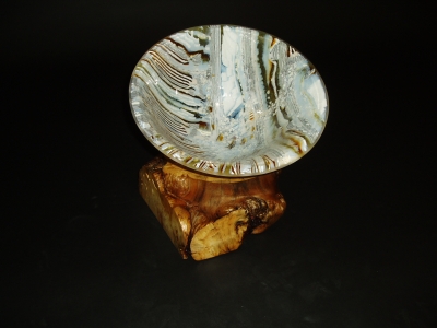

Re: Karl Harron 3 step mold
Glass Bowl with Wood Basejpeg.jpg (69.57 KiB) Viewed 17215 times
NOT a great photo but the vessel has a nice stretch to it.
