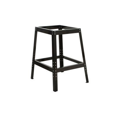

Would this work? $35
I would need to put a surface on top, is it safe to use plywood?
Rated to 500 pounds (with HF I just cut the number in half to be safe but 250 should be enough, I think).
18-3/8" x 20-1/2" (Top)
Up to 25.2" x 27.16" (Base–Leg Spread)
26-32" height
Looks like it might be a pain to put on castors, because of the way the kiln opens from the bottom it needs to be pretty far from the wall, but when opened by the upper hinge it can be much closer, so castors would be nice. HF has a kit but it cost more than the stand itself, $40
26-32" height

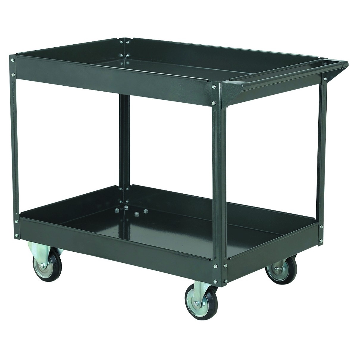

Also thought about this cart. Rated to 450lbs, all steel.
I looked at the instructions for putting it together and it looks like I could flip the top shelf to get rid of the lip.
24x36
$60
24x36
$60

No plywood. I used cementitious backerboard when I was setting up mine, and just laid them across cinderblock. I had a spare roll of steel flashing lying around and covered the backerboard with that (because it can really scratch up hands or elbows or whatnot), turned it under the board to make a smooth tabletop. Worked well, and gave me a big workspace to use for waiting projects or a resting place when I was pulling everything out of the kiln.
I've got the HarborFreight stand you're picturing and I would think it would be a bit topheavy with a kiln unless you put a shelf on the bottom rungs and kept something heavy on it. I also have the cart (HarborFreight forever!), and I'm not sure you could turn the tray upside down without weakening the support. You could either fill up the tray with lightweight firebrick and set the kiln on top, or just secure the backerboard to the cart and put the kiln on it.

Cinder blocks will allow you to adjust to a comfortable height. The stand and cart you show look too high... you would get a blast of heat in the face if opening kiln to check a 1500F melt!!
