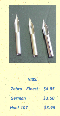

Thanks for the info Valerie. I've found some others locally which I'll be able to get sooner. I may order one of the Hiro, too, especially if the local supplier has them.
I'll post a pic of those I found locally. Thanks again, Jen.

I use a metal nib holder because clove oil melts plastic. I use the hunt nibs like in your photo. Two sizes.

Thanks Don. I was hoping you'd have some input. Which sizes do you use please? I ordered two Hunt nibs yesterday. Both will be the same size I guess because size wasn't mentioned, just a part number, 107 which is the only one they carry.  They should come in the mail tomorrow.
As for the nib holder..... the old one I have has a rubber grip around the lower couple of inches. Will check to see what the handle is when I go into the workshop. I think it is plastic. Whatever it is it has lasted for many moons already, but if it does disintegrate I'll now know why. Thanks.

I only use 107s. I thought I used two sizes but it turns out they're all 107s.
						Re: Pen nib for drawing with stainers?
The 107's arrived and they're not what I was expecting. They are tiny little nibs compared to what I was using.They are larger than life in the website photo. I think the one Valerie recommended is an option. I found a couple of calligraphy nibs. I'll try those. The one I broke was like a regular dip nib size (if anyone remembers writing with those).

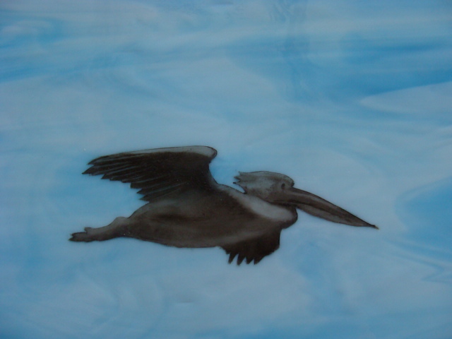

KaCe, here is a pic of the bistre brown and tracing black mixture so you can see the colour. I couldn't get it to post in the PM so hope it will post here. I've been able to post before so don't know what is happening with the PM. (Just one pic as the file would be too big to upload). This was still a work in progress but broke in the kiln as a result of the problem I was having with the GB4 (subject of another thread). Jen

nice painting!

Thanks, Don. Now I have to do it again. Will run a controller/kiln test before I fire the next one. Jen
