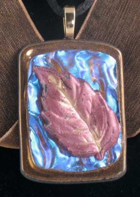

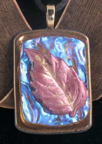

Here are 2 simple examples:
Floating leaf
Floating leaf

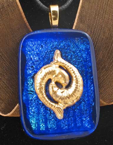

Yin Yang fish
Yin Yang fish
