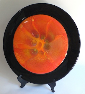

You could do it that way Jerry.....but for me I like a defined line for the rim like in this pic. If I had fired the pot melt with black frit around it the edge would have come out less even around the orange center.....does that make sense.....? You would also have to cold work the edge to do a slump.
This one was a 18" round of black capped with an 18" of clear with the pot melt in the center......
