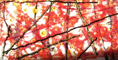

Posted: Fri Jan 31, 2020 8:24 pm
by Babette (Shawn)
I make my “lace” on thin fire, I think the thin fire allows the glass to slide better with less friction than a kiln shelf. I use fits, all sizes not powder.

Posted: Wed Feb 05, 2020 6:08 pm
by Sharol
Shawn. Great to see this photo of your lace. I miss being able to see your abstract (and all other) works. Good stuff!
