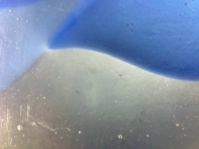

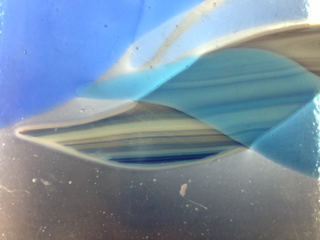

But my new piece does have halos..see attached. These may be minor..but are there such things as 'minor' annealing issues, or are any bad news?

Yes there is some stress between the blue and grey in the second photo. To determine whether this is annealing or compatibility stress, you need to run a test.
The following is a method that should give you answers.
http://glasstips.blogspot.co.uk/2009/08 ... tests.html

I called the manuf. and they said it they are all compatible. ( But I am not sure I trust that.) FYI - the glass is clear..it looks grey due to color of film. I have used these colors together many, many times without issues. but lately have had less luck. I think it is annealing issues.
I would like to know if it is SOME stress, can the glass survive with that?

yes, some stress in some shapes and items can stay intact for many years. Look at some 19th century paperweights under a stressometer and you'll be amazed that they have hung together for going on 200 years. Some cracked in a few hours, it all depends on many issues.
Re: Polarizing film- annealing- results
Compatibility comes in a range. At the bottom of the range there is no stress. At the top, there is quite a bit of stress. At any point, if you add enough additional stress, you can make a crack happen.
Stresses move in different directions, like compression and tension. When you add compression the glass actually gets stronger. Glass is stronger than steel in compression. However it is weak in tension. Sometimes stresses can balance each other out, resulting in a compatible equilibrium.
After glass cracks, the stresses realign. This can change the shape of the glass. I have seen 2 pieces of glass that used to be one, line up, and they no longer aligned at the crack. One was warped in a different direction.
