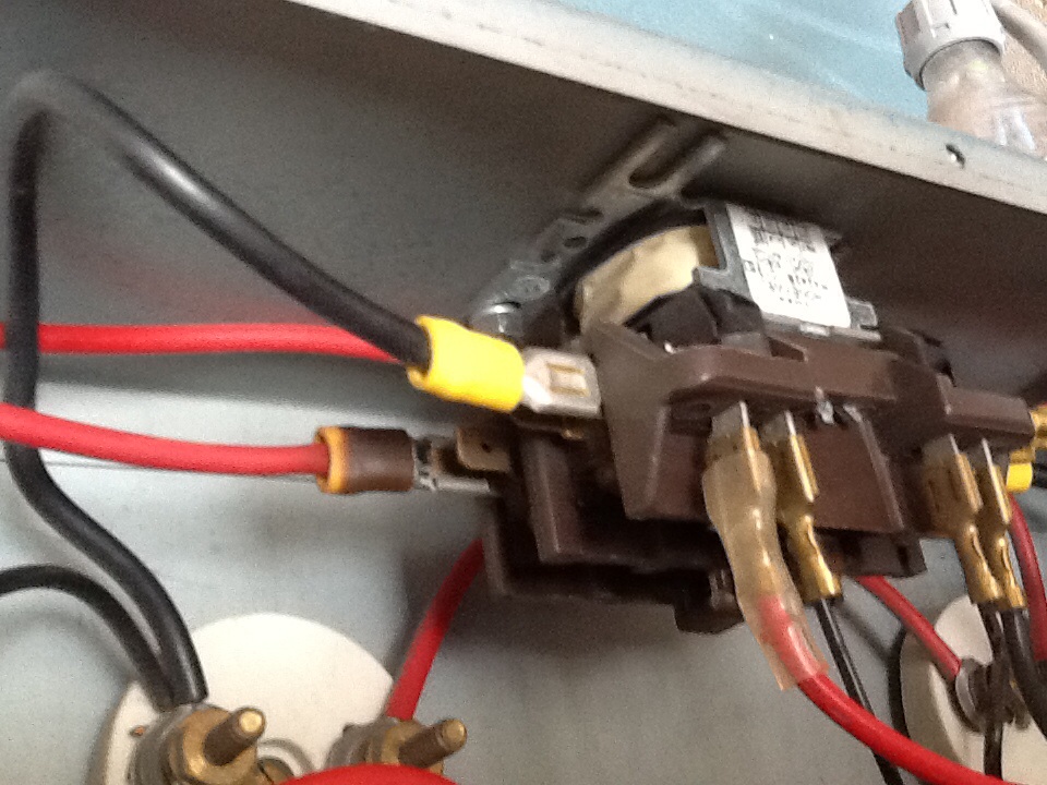

Took the side off the control. I do have two elements and it appears there may be a problem with one of the switches. I will be calling the kiln techs on Monday.

The photos should be rotated 1/4 turn clockwise! The bottom of the kiln is on the right of the photo.

Thanks Arnold - Tetlow did suggest adjusting the safety switch, and luckily for me the technician was out at one of the local schools, called in and changed the relay over as it was burnt out. Just waiting for the bill (can't actually believe there are still businesses that don't want payment on the day). It is now happily firing (as is my little Paragon test kiln - love it).
