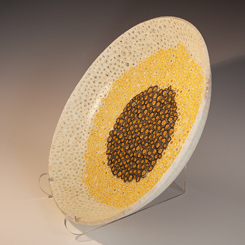

[/attachment]I bought a varitone backdrop from phototech when i made my first rod bowl. I used a sunny room and taped the screen on the wall and draped it on a table. I do have lights - i think the trick is to use a long exposure and a tripod for the camera. I realize this bowl is not perfect. Im learning as i go! the second photo has a simple light under the upside down bowl to show what it would look like as a light cover. .
- Attachments
- 4.jpg (34.79 KiB) Viewed 12995 times
