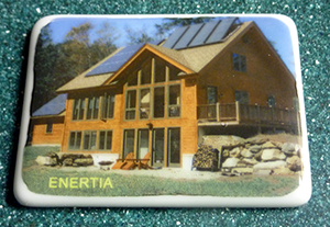

The website is very good at explaining every phase of the process. First I created a 10"x15.5" file in Photoshop which I set up as an amalgam of about 20 photos that I wanted to affix to glass in sizes of roughly 2"x3". The file had to be 300 dpi resolution, and meet some other criteria. They can not create "white" so that has to come from your background glass if you need white.
I uploaded the file to their website and paid the $40 plus $11 shipping fee. 3 days later I had my large decal sheet.
The glass for this has to be very smooth, and Spectrum is suggested. I'm a BE user, but got some white and clear Spectrum for this project. For the first attempt I fused a rectangle of clear base and white cap together in advance of applying the decal. I did a second one with just a single rectangle of white with no advance fusing. As per the directions, I cleaned the glass with denatured alcohol. Then it was time for adding the decals.
I cut the decals apart from each other and soaked them in warm distilled water for about a minute. When the decals started to separate from their backing I completed the separation and placed them on my glass. I used the foam edge of a diamond hand pad as a squeegee to get the air bubbles out from behind the decal (which was easier than it sounds). Then I fired according to the schedule on the site. I do have a very small kiln (Evenheat Studio Pro with manual controls) so I did adjust a bit by speeding up since there is not so much lag time for the glass to get hot in such a small kiln.
The result was perfect! The color is good. The images are fairly sharp. There is a nice gloss. I intend to put a clear cap over the one on a single layer of glass to see how that looks different from the one with the image on top. And there is a lot to try with different base colors and even perhaps textures….
If anyone is thinking of trying this, I encourage you to go ahead. At $51 for 150 sq in of decal, I figure that my 2"x3" photo tile cost me around $2 for the decal - plus glass, etc. For gifts, or some sort of commercial project, that is not too bad.
I'll attach a photo. The tile looks better than this, but I need to work on my glass photography techniques:)
Emily
