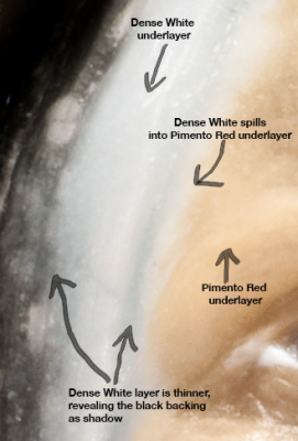

Osnat, this is an example of what I'm talking about; it's a closeup of a portrait I did a few years ago (the full portrait's in another thread on this board).
The white areas next are only 1401 crystal clear until about the 15th layer. Then there's a layer of opaque white. It stops the light and makes all the layers above it look very white. If you see this in person, there's no grey there at all. The background is black. I deliberately thinned the white layer in spots, letting the black show through to create the illusion of shadows in the hairline.
You can see where I've made a mistake (or it's slipped in the firing) and the white layer has gone beyond the hair and into what's supposed to be the skin. Even though there is a lot of colored glass above and below that thin white layer, it's enough to turn the skin white.
Hope that helps.
There are about 30 thin layers of glass in the skin (apricot-colored) section. The top layers are 1401 crystal clear, mixed with increasing amounts of Light Peach Cream and Coral Orange Tint in successive layers. At around the 20th layer, there's a very fine sifting of Pimento Red powder. Pimento Red is so concentrated that it gives that super-warm tone to all the layers above it. (There's also a layer of transparent plum around the eyelids to give them darker shade. It's sifted right before the pimento goes down, but it's hard to see here)The white areas next are only 1401 crystal clear until about the 15th layer. Then there's a layer of opaque white. It stops the light and makes all the layers above it look very white. If you see this in person, there's no grey there at all. The background is black. I deliberately thinned the white layer in spots, letting the black show through to create the illusion of shadows in the hairline.
Hope that helps.
