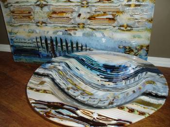

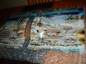

I purchased a new slump Mold from Laurie Spray and I simply LOVE it. So thank you so much Laurie. Now off I go to slump more pieces. Les

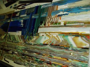

Oh I forgot to post the panel part also . BUT now I am going to slump the large panel as well, it is 32 inchs x 19 inchs and it is an experiment to see if my kiln will handle it.
Hmmmm!!!!!!!! Les

I am so glad the papa drop ring not only got to you safely but that you are so happy with it!! This 22" is the largest drop ring I have made so far. Look at the prototypes I have coming for 2014! (under "Other Molds, then Prototype ideas) We would love feedback on these ideas! I would love you especially to look at #3!
Love the colors in this piece!!!!! :)

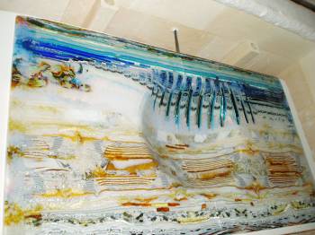

Well I have decided to practice a slump with the large 32 inch panel in behind this bowl. I have to do 3 large 32 inch by 19 inch by 6 inch deep slumps and well, my kiln might be just abit small but am trying it anyways. It is in the center of the kiln with top and bottom fire, BUT close to sides . Only 4 inchs away on each side. My problem might be at the corners. Will keep you all posted for sure. Les

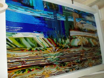

Here is the start of my new 3 large vessel's that will span 9 feet. Exciting. Les

Well so far the slump looked really good so now we waite. [-o<

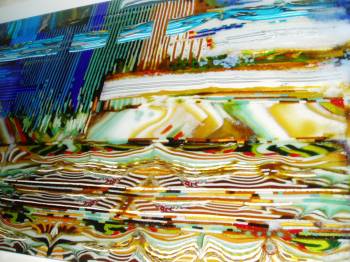

Large deep slump panel comes out tomorrow and this piece is ready to go in and has 3 large panels that will all be slumped like the Dense white/ French Vanilla / Opaline / and pulled canes from hot shop.

Well we are what our equipment is. Oh so darnit. BUT it is still workable and Rick Wilton is helping me with some polishing bless him. With my kiln being just to small ;pieces that I want to try I just should not anyways, and should know better, but just have TO TRY anyways, to break the piece when I should not have tried in my kiln. How is that for a sentence. BUT it is in 2 pieces now and still will be a lovely bowl when my metal worker extraodinaire gets finished. So keep posted for the final piece. Ughhh but not let down yet.

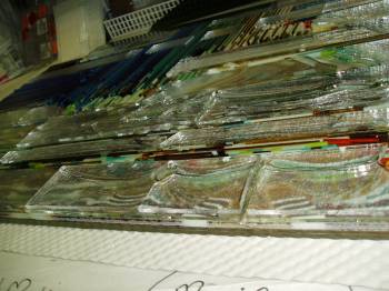

Well the new panel is now flat firing and will be slumped in my girlfriends kiln. Sad that we are what our equipment is sometimes. :-k [-o< So I will pray that it will slump better in a much larger kiln. Does any one out there ever have trouble slumping through fiber board. Just a thought as it is an insulater and when slumping through it, the middle is cut out, causing quite a temperature difference around the slumped part where the glass is not touching the fiber board. So I am going to try to put a slump mold underneath the fiber on the next slump to actually help get the heat more consistent throughout the piece. Does this make any sense to others out there. :-k :idea: Leslie

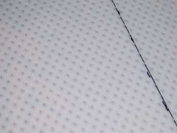

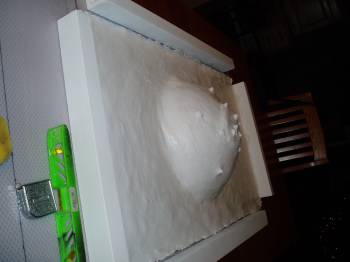

Hi Sue, how are you. The kiln is not wide and long enough. LOTS of room above and below but tooooo close to outer edges. BUT I am making a mold mix 6 slumping mold right now and am renting a friends kiln in early January so will be able to have lots of room around the outer edge. It is a top / side fire which I think will be even better so no where will it heat up unevenly as I will baffle edges tooo. So I have got the MOLD MIX 6 applied now and just hope it does not curl tooo much on outer edge. I am calling it the "PINK ALLIEN" as it is dyed pink on outer layer. Anyways, will try to take a pic for you.
Les
Re: New Slump MOLD
Posted: Sun Dec 29, 2013 5:39 pm
by twin vision glass
Had to make a wax mold of a vessel and then attach it to a large 35 inch flat area and now hope it will not curl on me as it drys which is one of MM6 downsides. The tooth picks add air holes but also tell me how thick I am while putting on 6 layers (dryine each layer before adding another. Hmmmm! so I hope this one works as it was a gallon of MM6 :-k [-o<

Would it help if you mist the edges with a plant sprayer as it dries?
Might it also help prevent the mold from curling if you turn it over and remove the form so that it can dry from both sides?
A temporary support that is cut out to go around the dome (plywood, or maybe an old card table) with a brace attached to hold the centre in place might work ( I was thinking sort of like flipping a stained glass panel between 2 boards when soldering)

Hi Joe, long time since I have heard how you are. Well I do hope. Mold Mix 6 is abit finicky and is very fragile until well dried and fired. BUT good ideas for sure. I am putting long Kiln Dams that are 36 inchs long that will help to keep it from curling so I will let you know how that works. Not sure were to burn (very carefully) the wax out but will figure that out in a few days. I usually do out side but since it it minus 10 C. that might not be an option.

I don't know if you will have to burn the wax out, as on a form with as much "draft" or clearance as this one, the only thing that will be holding the wax in is likely the toothpicks.
If the toothpicks are there to form vents, some one like me would CAREFULLY trim the MM6 on them down to the surrounding level, then pull ( or maybe drill ) them out of the MM6 to release the wax.
After that, maybe just putting it outside at -10°c might make the wax shrink up enough that it will fall right out.

Yes the toothpics have to come out and usually when you gently burn the wax out with a tiger torch the toothpics burn out first leaving a very nice vent. AND well, because of the water in the MM6 it would be not super good if the mold froze and maybe cracked BUT that is a really great idea and I wish I was brave enough to give it a go. All I need is a good garage to burn out though. So I will keep you posted in a few days. I like torching because it cures the MM6 and makes it really strong before even going in the kiln to then go up to 1500 deg. F. and after that PRIME.

Perhaps a really interesting thought tooo was to create this large mold on a plastic form that has tiny little indents . My thinking was that it will gently hold the large panel in place while the center slumps down. Sometimes it tends to want to pull the edges inward but this will prevent that and also give air under the glass until ready to slump. Like tiny little hands holding it up off the shelf until slump has occured , helping to not thermal shock the piece. :-k
So fun thinking of new ways to approach things.
