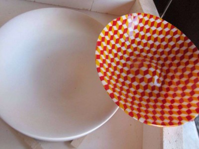

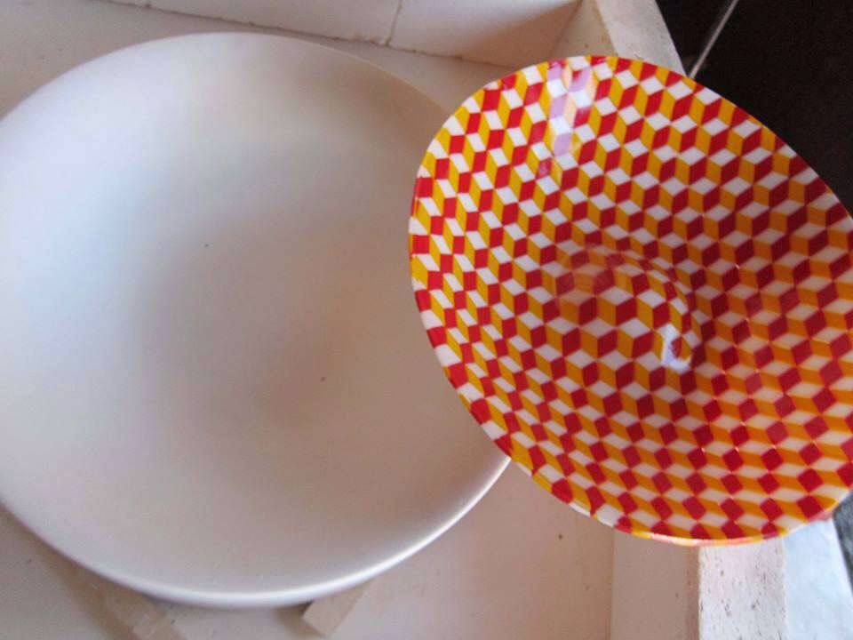

A couple of months ago I tried my first large bowl and and it had a huge hump after slumping in a bullseye mold- Brad and laurie helped me figure out what the the problem was. NO hole in the center of the mold seemed like the cause.. My first schedule was
large hump
large hump
130-800-15
100-1200-30
9999-950-60
100-700-
200-500
300-200
to fix it I drilled a hole in the center and reslumped it (after praying to the kiln gods)

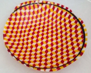

Marked circle for rim
( The color is too yellow in this pic)
I did need to take off about 2 inches as the rim slumped uneven with the higher temp

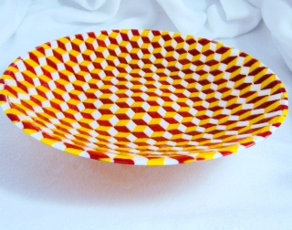

I am so happy that this bowl survived after all that work. It is one of my favorites to see!! Yeah!!!
Re: big bubble at base of bowl
I look at all those tiny pieces and just marvel that there are people who have that kind of patience! Glad you were able to save it.
