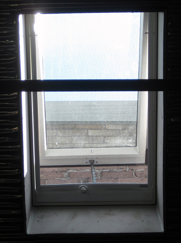

A window!
By the way, my studio didn't have any windows so I installed a sky window. Its like a skylight, but it opens up allowing air to come in and out.
Have a look!
