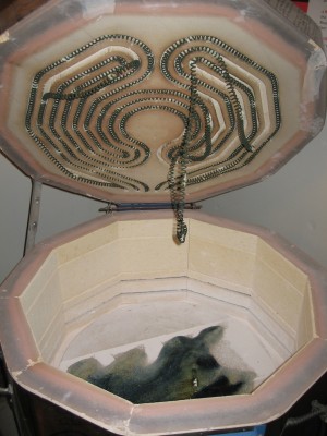

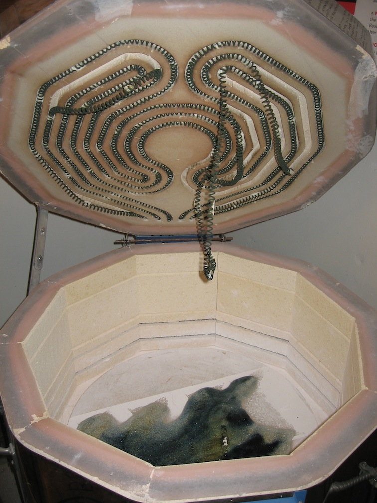

Here's a photo of my 14 year old Paragon, after a relay failure a few years ago. What you don't see in the photo is the giant crater that was left in the floor after I chipped out all the glass that overflowed the shelf. I replaced the relays, tucked the elements back in place, carved out and replaced the bricks in the floor. I use this kiln daily.
